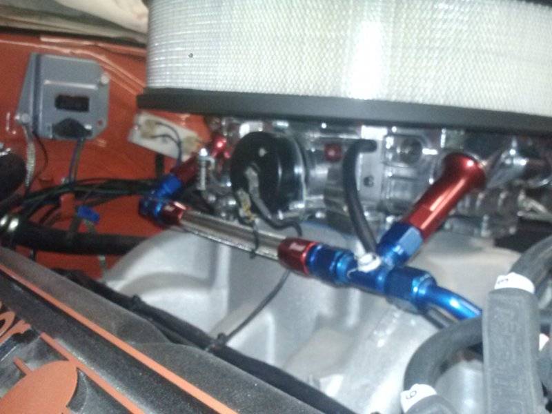

I was able to cut the carb side if a mancini racing low pro base to get my setup to clear. Still a good gap for air, topside is the mopar performance cast plate, and std paper filter that came with it. stock rb block (512") with indy dual plane mani.

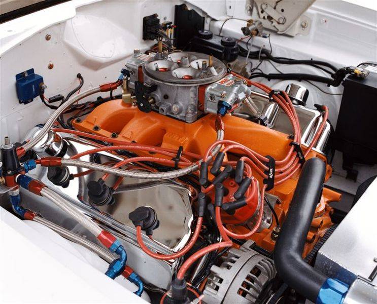

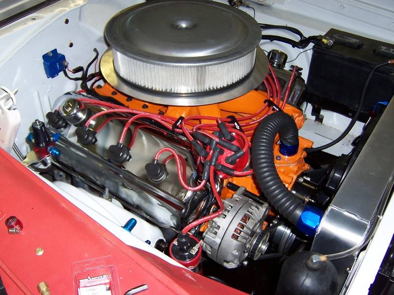

This car, was an exercise of "space-management". Hemi, Indy single-plane, Dominator, and 16" air-cleaner. Less than an 1/8" of clearance, once finished. We milled a 1/4" off the intake, cut the base-lip of the air cleaner in 1/2, and I had to put major dents/dimples in the base to clear the float adjustments. I also spaced the k-frame down an inch or so.

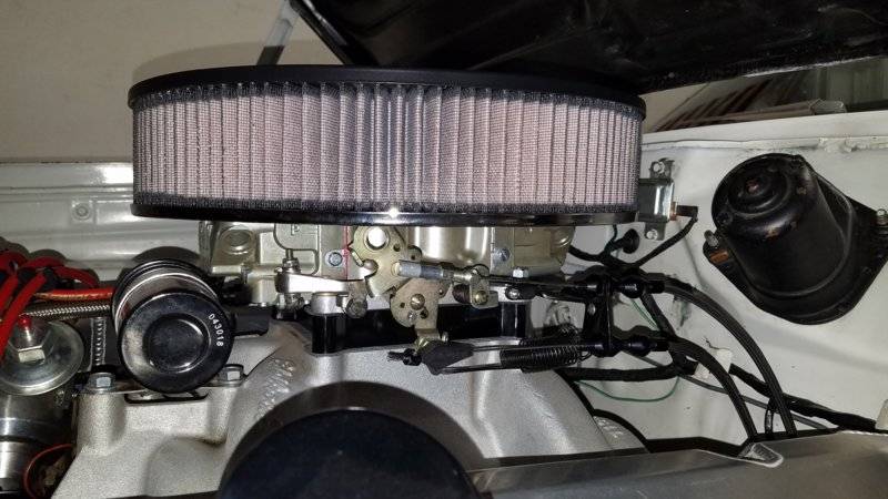

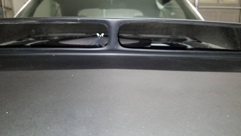

Drop base for my '71 and gave me a little bit over 1" clearance. Second photo is the lid
