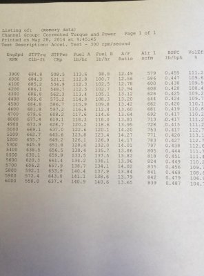

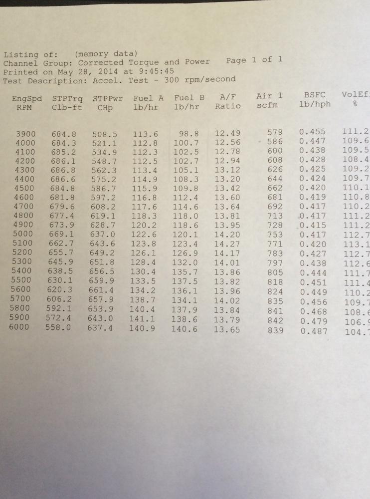

So I finally got the 512 dynoed yesterday. Builder used a victor440 manifold. No way is it going to fit under hood of stock 67 coronet. I ordered a torker2. Will that fit? Edelbrock says I won't lose much power at all with that manifold
See my post. I'm running a RB w/T2 intake. Sorry, no pics.
Oh...so what about build specs and dyno numbers? :headbang:
512 stroker
Comp custom grind 242/248 590 lift 111 sep
Eddy Victor heads 370 flow intake
1000cfm demon
660 HP @5700
690TQ @ 4500

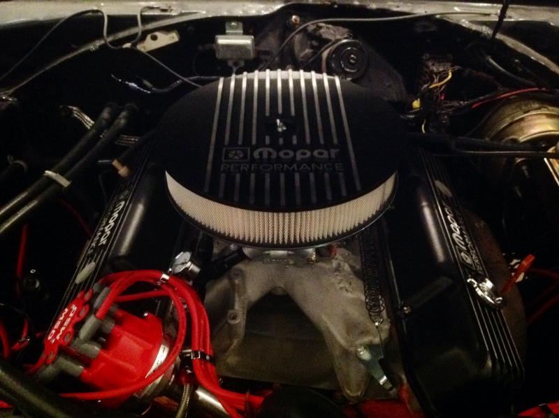

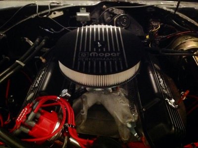

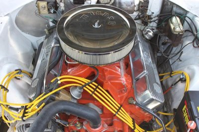

I used to have an edelbrock performer but I recently replaced the intake (again) on my 383. I used the TM6, which I believe is similar in height to to the torker. Also using With a holley 4150 and a mopar air cleaner. Fits fine under the hood of my 69 charger just fine. Hope this can help.
