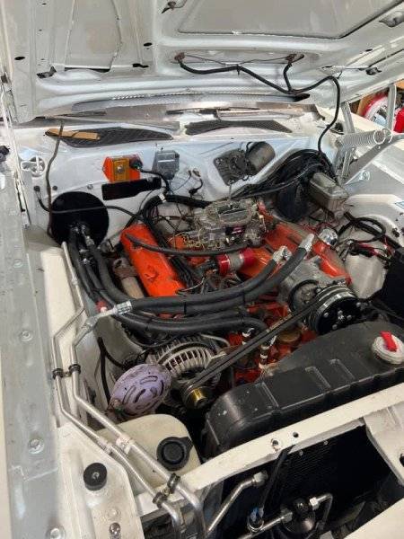

Hood mounted turn signals for a 71. Does anyone know and or have pictures of how the wires are routed on the underside to keep them tucked up and off the engine?

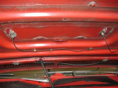

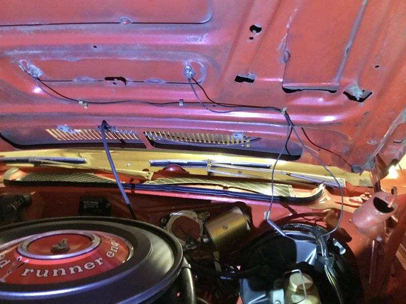

Nowhere near sure this is factory. Just know this is where mine are. Have to zoom in. Tried to zoom in and take a screen shot. File
Was to large.
See how mine are run, original wires to hood turn signals lights.

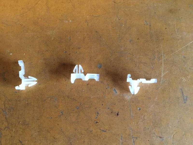

I took a picture of one at the MATS several years ago when I was replacing mine.

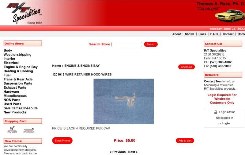

Thanks to all who posted poctures. 71RRHI- I wonder what was used to clip it up lole that. I know it's not a "Zip-tie". Also to all, the tab in the middle of the hood, I have that same tab but I've seen where that wasn't used. Wonder why?
