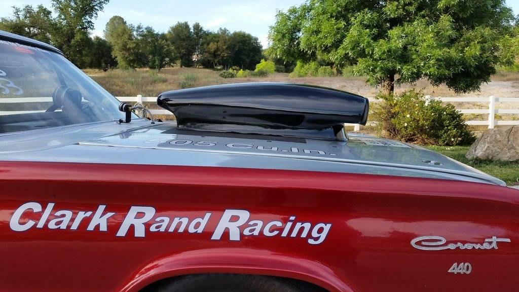

Although My Hood is fiberglass, it is a hinged hood and is very, very heavy. I have the Harwood Aero scoop on it. It all works fine but.....
When I have exhausted all other avenues for a personal best ET (10.36 right now but I hope to get it into the low 10.20s early this fall when the adjusted altitude is around 500-750') what is the opinions on removing the hood to save about 50lbs off the nose. Will the hood being off cause more wind resistance and negate the weight savings.
Who has had direct experience with this....???
The weight does mean something but the air drag of an open hood means something the faster that you go. 16 second car? Not much of an effect. 10 second car? I'd rather have the hood on for that ride.
