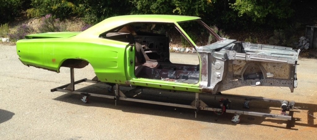

Have a look at the picture below and you will understand why this is not a decision I have to make today....got a lot more work to do on the body shell.
