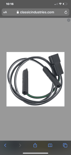

They plug into bulk connector on firewall. There is a plug in wire that then has the 2 female connectors where the male ends off of the turn signal wires plug into.
So there are 2 wiring parts. The one off of signals and the one from bulkhead to signal wires.

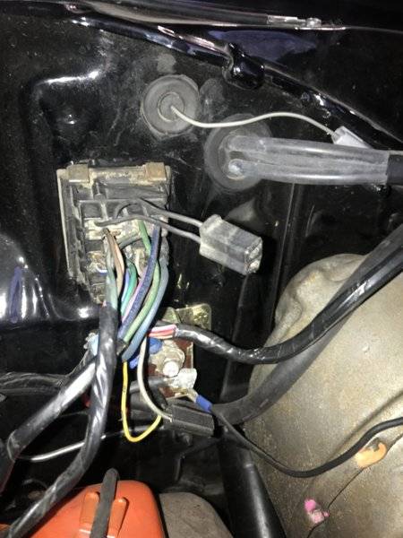

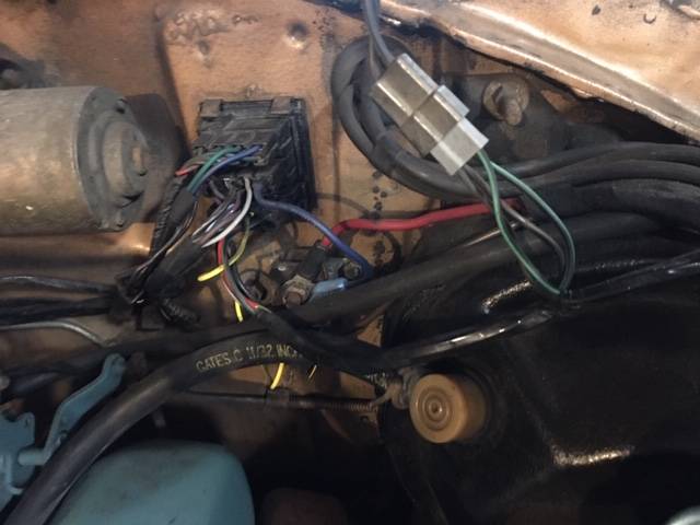

If the OP doesn't mind, I have a similar question about the amber hood turn signal indicators on either side of the "440" badge that faces the windshield.
See pic. The signal lamp wires are there, but I don't know where to connect them on the bulkhead wiring block. 70 Roadrunner.
On My 69 Charger Theres Only One Wire Coming Out Of Each Turn Signal Port
The 69 harness has the splice down a few inches from the bulkhead connector. The plug for the hood harness is by the brake booster or master cylinder. The other possibility is that not all Chargers had hood indicators. You could have a blank metal plate in the hood originally. I would think the light harness would be the same.
Comes from the bulkhead, wires are black with green and yellow tracer. The connector is just to the right as viewed, by the booster.
