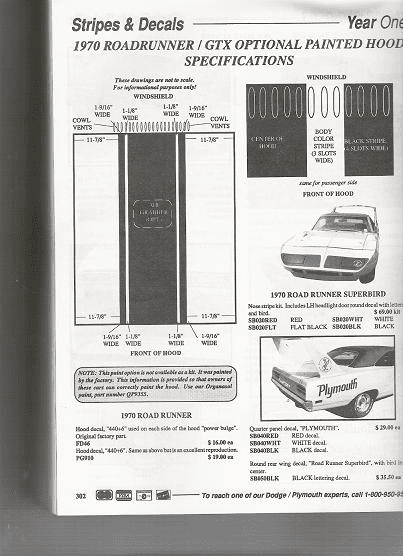

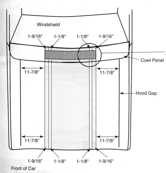

Hood performance paint V21 is an option. It was in done black only. Not many cars got that option really.
The J45 Hood pins themselves bolt to the body into the fender bolt place. So if somebody want them gone they could remove them, install bolts and swap hoods.
both of these would be on the fender tag if car had them so you’d didn’t have the hood paint.

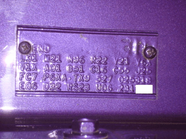

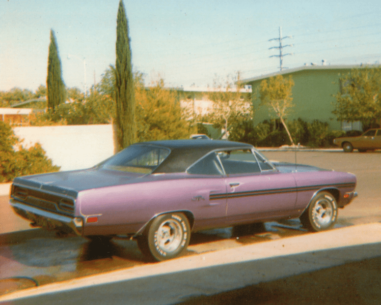

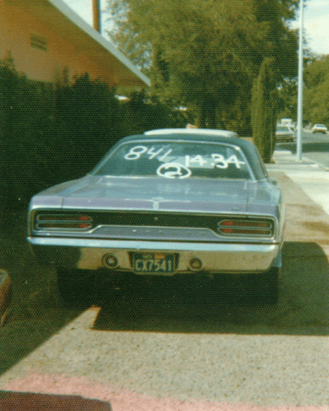

Here is the Fender tag from my ex GTX....V21 and had blackout on the hood and tail panel...
Photos taken in 1972-73 in Las Vegas.....
And some useful information for your painter...
The tail panel blackout was standard on every 1970 GTX. Kind of like the emblems, they all got them, no codes, nothing on the fender tag or broadcast sheet.
Tail panel blackout has nothing to do with the V21 or any other stripe or color option.
