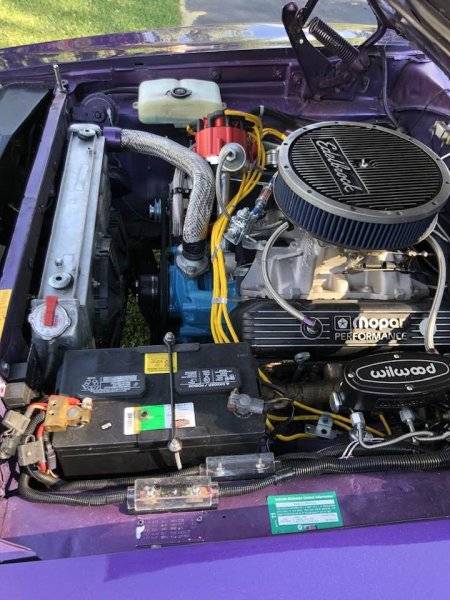

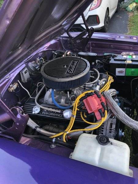

I think you are perhaps looking at the problem too narrowly; as you stated (correct me if I am wrong) you believe that the engine is getting hot just because the hot air cannot leave the engine bay. While this is 1 potential issue I personally would not focus on that since pretty much all cars of this era were similar and most remain that way without the issue you have.
So I would look at other potential issues, the lower rad hose is a good one which you have already addressed, so this leaves
Radiator issues (size, effectiveness, etc.): you didn't say but from the pictures it appears like its a GM style cross flow. It "might" be on the smallish side but hard to tell.
Timing (perhaps too advanced just a bit): You commented that the car runs great overall so this probably isn't an issue.
Lean condition: From the pictures it appears that you are running a carb so this probably isn't an issue however w/o a AFR gauge its hard to say. Personally I think every car should have one as it exceptionally helpful to understand what is happening.
Water passages (restrictions/debris): Although possible its not probable as it remains cool at low speeds and idle.
Fan (size, speed, CFM, etc): This is more times than not at least a significant contributing factor to this issue specifically. Clutch fans are designed to "engage and disengage" due to the temp of the thermal spring inside of them, this is a failure point. Flex fans are designed to flatten out at speed/RPM so as not to draw unnecessary HP as it is thought that at speed the air flow will be sufficient. Here again, this factor can be problematic as at idle/slow speed the flex fan is just barely hanging on but at speed it is not pulling enough air. Electric fans suffer primarily from using too small of fans for the application.
IME heating problems such as the OP is experience is not a 1 thing issue, normally it is a combination of issues which makes fixing it difficult.
As to putting louvers in the hood, thats your call as it is your car but I do not think it will have the effect you think it will. Yes it is hot under the hood but the engine doesn't care because it is using a sealed system, the ambient air temp under the hood generally is not significant as it relates to engine temp UNLESS it is significantly high like with huge HP, turbos, headers, etc.

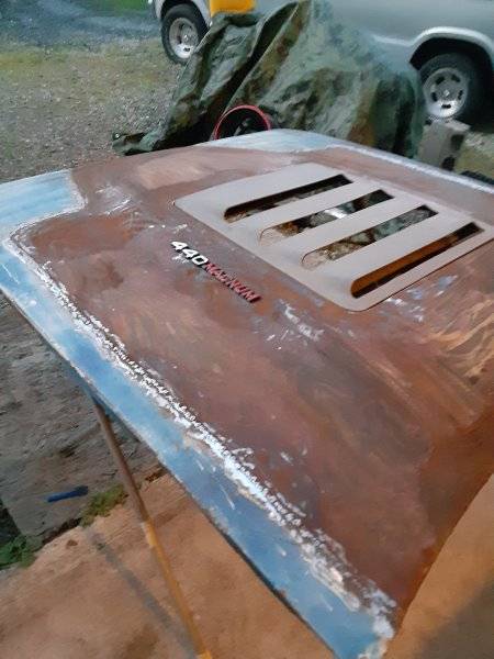

Yup! Had to separate the hood from the structure anyway to soak it in Molasses to remove the rust.
Built my own louver punch and die. And added baffles so the engine compartment stays dry plus more vents in the substructure to let the heat out.
