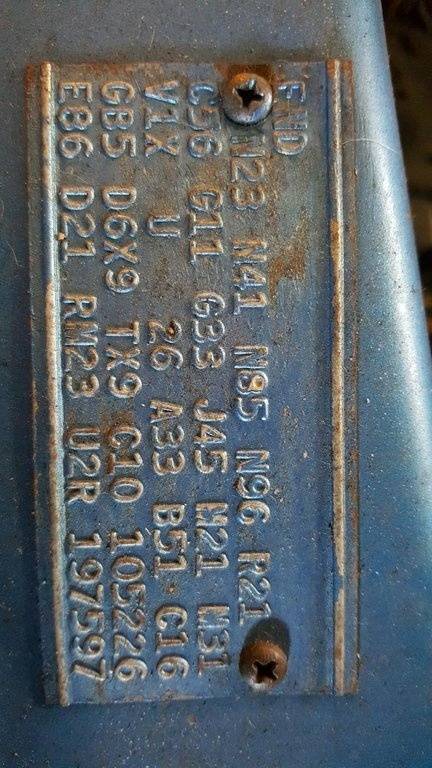

Here's a pic of the engine tag. I think I have it decoded properly (using the internet here, so hopefully close). Car seems to be in good shape from lots of pictures but I won't see it for a week or so (it's not in my area). Now for the questions; It's not a "numbers matching car", although it does have a correct date coded 440 in it. Is it worth investing $$ into a car that's not numbers matching? In the pics, the car has a pistol grip shifter, but I don't see that on the engine tag...if that code's not there, does that mean it originally came with a slapstick? If I purchased the car, should I put the slapstick back on it or does this not matter as far a keeping it true to stock. It's a GB5 car (metallic blue)..current owner states it had a respray about 5 years ago. Is there any way to tell if it's the correct blue other than eyeballing it? Engine tag says it had hood pins, but the car doesn't have them now. Is this odd? Why would someone take them off? When I look at the car, I will want to match the engine tag to the body stamping, but for the life of me I can't find the location of the body stamping for this car anywhere. It's it on the inside of the trunk lid? Last - what else should I check for to ensure I'm getting what's advertised and that it's (somewhat) worth the $$ (he wants $45k). Sorry for the long post...thank you in advance for your expertise!

D21 = 4 speed car
it came with a pistol grip
the fender tag looks real
hood pins gone could mean many things

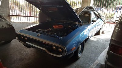

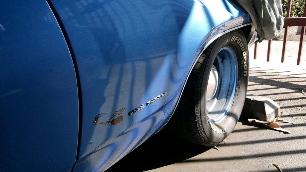

ok, couple pics..sorry for the bad lighting..it's in a garage all covered up.

Really? I got this off a mopar fender tag site:
U2R
U = 440 280HP(net) or 290HP(net) 1-4BBL 8 CYL
2 = 1972
R = Windsor, ONT, CAN
here is what i know..
n23 = 70-71 Electronic Ignition System
n41 = dual exhaust
n85 = tachometer
n96 = grabber hood
r21 = 69-71 AM/FM Radio (5 1/2 Watts)
c56 = ?
g11 = 69-71 Tinted Glass (all)
g33 = 70-71 OS LH Remote Racing Mirror
J45 = 69-71 Hood Tie Down Pins
m21 = 69-71 Roof drip rail moldings
m31 = 71 belt moldings?
v1x = vinyl roof black
u = 440
26 = rad support
a33= 69-71 Track Pak w/3.54 ratio
b51= 69-71 Power Brakes
c16= 69-71 Console w/Woodgrain Panel
gb5 = blue body color
d6x9 = black bucket seats
tx9 = black door frames
c10 = ????
E86 = 69-71 440 cid 4 barrel V8 (High Performance) 375hp
(that changed in 72 to less hp)
D21 = 4 speed transmission

C56=Bucket Seats
C10 should be the scheduled production date, C=December 10th 1971. If the original safety sticker is still on the driver's door, should be able to verify the month.
one thing that comes to mind is if hood pins are gone,
i would make sure it is a real grabber hood on that car
not some converted over flat hood..
Does the vin # match the fender tag. If the vin doesn't start with RM23U its not a RR GTX.
RR bird would not have been on the quarter of 72.
Are the GTX emblems on the door side of front fenders and passenger side of trunk lid.

If it had hood pins are the holes still in the core support.

I am not sure you could get hood pins with the graber hood.
Does the owner have the build sheet. It will made deciphering the cars options easier than the body tags.

I have never seen a full vynal top GTX. Half vynal and roof belt was common.
