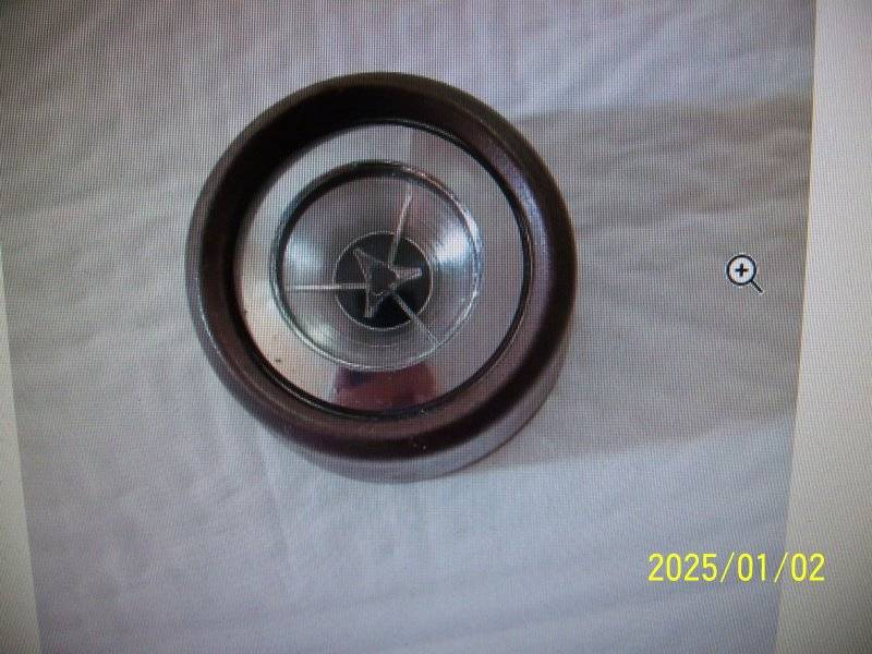

67 Coronet - need the adapter for horn button for woodgrain wheel.

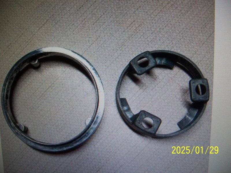

Can I get your email so I can send you more pics of what I have, wheel included and maybe you can set me straight on the Assy?

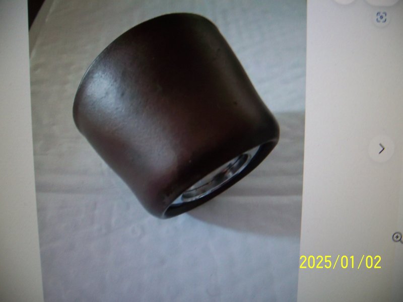

Thank you in advance for the help, this is my situation. This is the wheel. Cap and mount for the cap that is mounted on the wheel now. The last pic is the cap I want to mount but wont fit the mount that is on the wheel now.

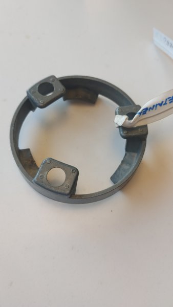

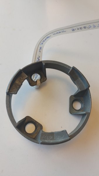

Take off the mount you have and grind down the outer 3/8" or so lip on it and it will work fine with the other cap. Done dozens of them. The screws you're using aren't correct but if they work, that's good. That's the 3 screws, and adapters I was talking about. You have the correct horn switch. I can't see the back of the wheel to see if that chrome collar is there but needs to be.
See post #13, it shows the modification described by 1970RoadRunner.
