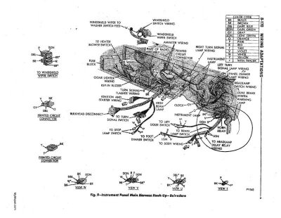

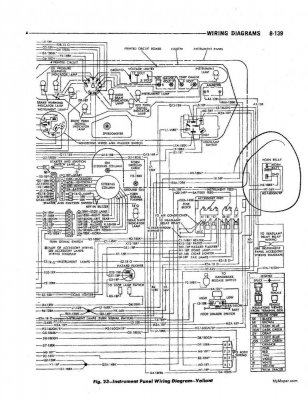

I know my 69 has a horn relay,but the wiring harness(new) for this 70 roadrunner looks like it plugs into the horn, does it have a relay? Also there is a blue wire (female plug) on the passenger side of the intake ,not sure about this one either,any help is appreciated.
Here is the location of the relay and color of wires.

I found the relay, under the dash. Thanks! Like A383Wing said not an electric choke in 70. I have the old harness an it looks like a relay or control(whats left of one) plugged into the blue wire with a part # on it, I will have to look!
