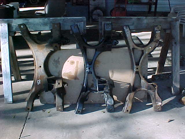

I just used my pressure washer to get all the crap off.....does a pretty good job. Sand blasting puts sand in all the hard to reach areas and seems like it comes out little by little over time. Not a good pic but this is what I do to the ones going into other than stock restored cars....the one on the right is 26 lbs.
