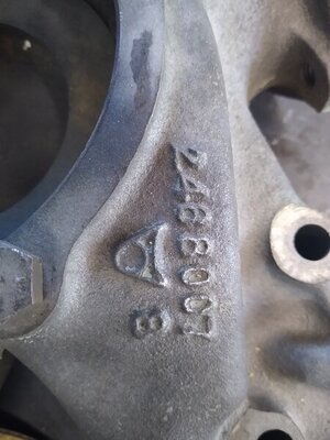

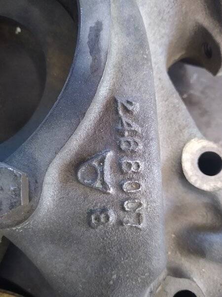

Have a 1965 426 wedge. I am trying to check dates on all components. This is the water pump housing number 2468007
7x13

1965 and 1966 B, C, D body 361 383 413 426 wedge. 1965 and 1966 B body 426 hemi. Part number 2585314
