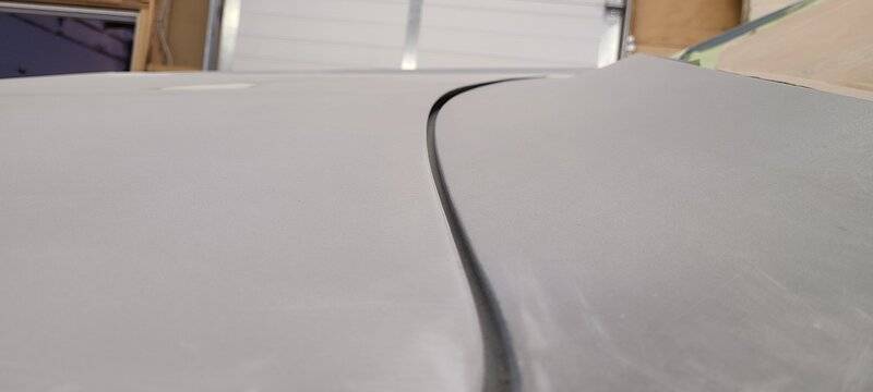

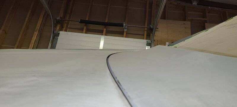

My trunk lid is around 3/8 of an inch higher than my Dutchman panel. I have spent countless hours and 2 lids trying to get it down further. I even went to the extent of ovalling out the holes a bit to get more travel. The only idea I have at this point is to put a jack in the trunk and push the Dutchman panel up to tweak it into position. This is an original panel, so therefore the factory could have had it this way, but I want it flush. the trunk lid fits everywhere else perfectly.

What has been replaced/repaired on the car, quarters, dutchman panel? If the corners are fitting and the center is still high I'd prop the corners of the truck lid up on blocks and try working the center down by hand/foot. I had to do this with a hood once, ended up bouncing up and down on the hood but it eventually laid down. Just go slow..
Now if the Dutchman has been replaced you may start there, if you do try pushing it up always use a fairly rigid board the width of the panel to achieve this. Simply pushing on the center will put a peak in it, a firm board will spread the force and keep the arch even.
If two lids have the same issue then the problem isn't the lid, its the panel. Maybe ask another member with a properly fitting lid to measure from the trunk floor to the lip on the panel and compare that measurement to yours.
The front Corners are fitting fine, but it gets gradually higher in the middle of the Dutchman panel

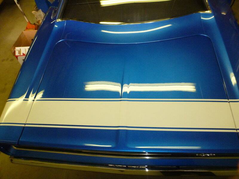

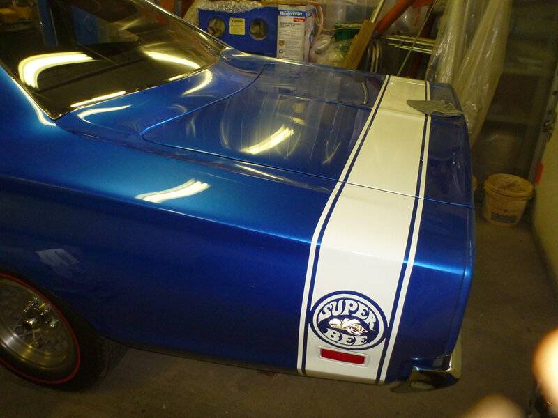

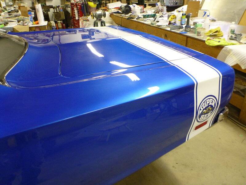

Why I showed mine, if you have the corners flush the center will be high...
Did someone sit on the dutchman while working in the trunk??
I was trying to figure out what you meant by "stuff the corners"! So you're saying yours fits flush at the dutchman but the corners are low ??
Yes, why I showed pictures Stan so he could see they're down an 1/8th or a bit more. If you look at those shots you can see the quarter panel showing vs flush at the dutchman. It's just the design of the trunk lid, as my old one and the better one I got from a member here both fit exactly the same. Everything else.... sides, Dutchman etc are perfectly flush. Same as leaving a front fender just slightly higher than the door to cut wind noise, but a bit more drastic.
