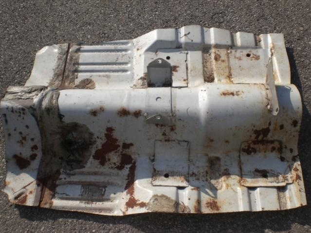

there are 2 brackets that get welded on to the hump. you can probably weld it more forward or back as long as you keep the spacing correct for the bolts that screw into the buddy seat. a member on the forum was selling repop brackets, iirc. do a search.
here's a pic of what they look like.
