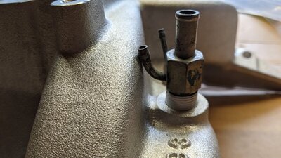

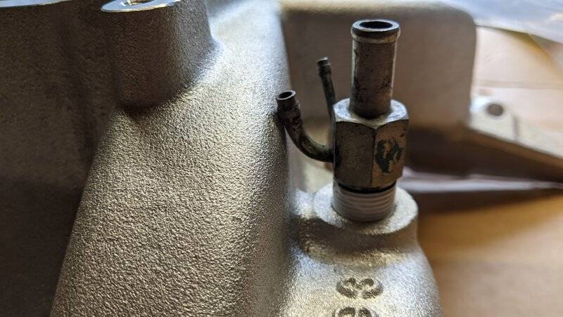

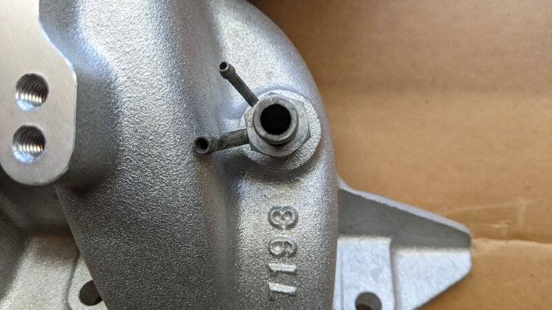

This is on a 73 Roadrunner with a 440. The vacuum port does not want to screw in without hitting the intake. I weary at bending in the connectors as the may break or collapse.
Any suggestions?

I would do away with that vacuum fitting then go the the parts store and get the necessary fittings to fabricate something that will work.

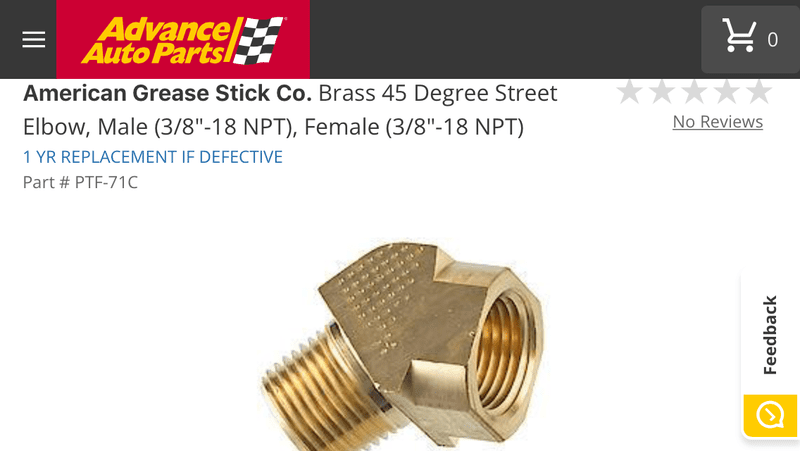

Ah maybe a nipple and a 45 degree fitting??
Or just grind a tiny bit on the manifold runner.
It is only about 1/2" thick. You only need a few thousanth's to clear the nipple.
A friend had this problem. He put the fitting in a vise, inserted a piece of wire in the inside of the connector and put a little heat on it and bent it up, so he could get the clearance for the hose. The wire stops it from collapsing.

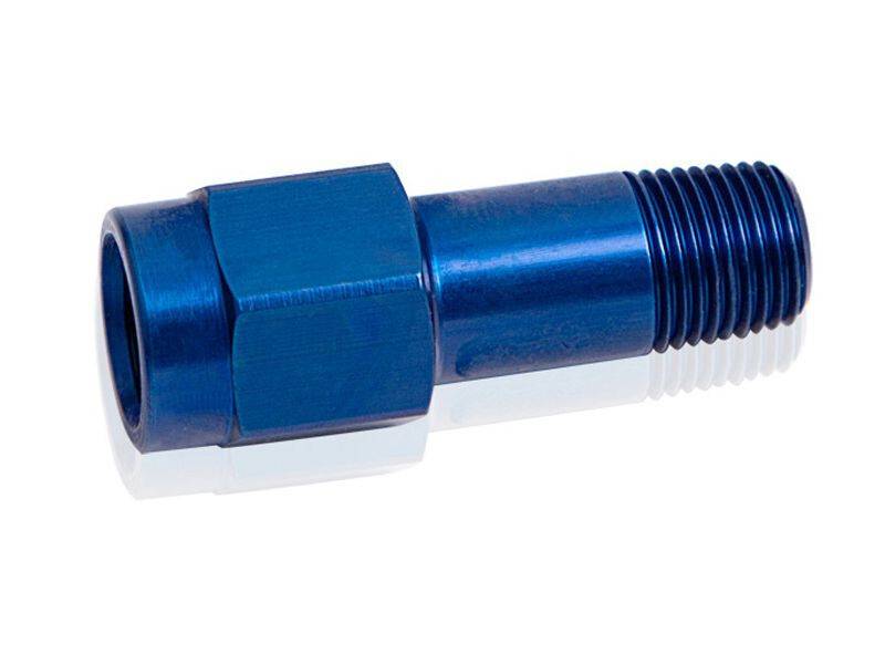

Good idea. You can also just get a 1 inch extension fitting to raise that vacuum port fitting.
Wow, great solutions, I think the 45 will work very well, otherwise I will see what I can build from parts. Off to the hardware/auto parts store tomorrow to see what I can find!

Agreed Edelbrock should have put that boss in horizontal. Any 45 or 90 that will screw in. The 45 my hit the rear bowl on a Holley.
Thanks, that is good to know. I'm going to be using an Edelbrock AVS2 carb but I will have to watch that there is clearance.
