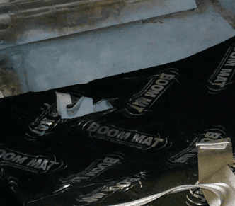

Hey all. Can't seem to figure out how to remove my back seat so need some help. Last time I had to do this was way back in the 80's. I seem to remember that you had to push down on the seat in the front.

Yeah, there's a "rear facing hook" on the floorboard of the car. The seat has a couple metal "loops" that fit into those hooks (located on front side of bottom of rear seat). You have to push down slightly and push the seat bottom back, further under the rear seat back, about 1-1/2" to clear those "hooks" and then you can just lift up and it will slide out.

Will do! Would love to find the build sheet under there but seriously doubt it as a new carpet was installed 2 owners ago.

Sometimes one side can be a pain....Use one knee to press down on one side to the floor almost and push the front towards the rear....
Rear seat hold down.
Yep! Tonight's mini project after a drive, seeing it's been raining since Monday.....Should have bought an ark....
