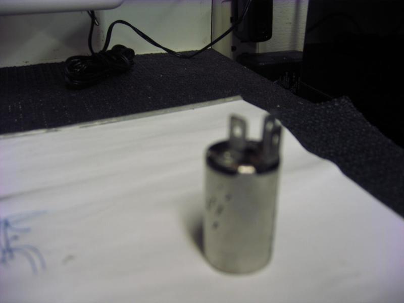

I believe it is connected to a (15-30 sec) timer that is triggered by the door jamb switch. The timer is a silver can, about the size of your thumb.
it's actually connected to a capacitor under the dash that holds a charge for 20-30 seconds that lights the light. I changed mine out a few years ago.
ill look for the pic and post it

pic of the capacitor
ill get the p/n when I get home tonight
Thank you,,, this is the one I thought. The harness has the following, relay, the male plug for the courtesy light and the yellow cable to trigger when the right side door is opened. I asked because I have a spare harness which has other connection which includes a Light Bulb. I'm not sure if this is right.
The part number I have is 2889565. Ignition switch time delay light relay I had to replace mine in my 72 Coronet
