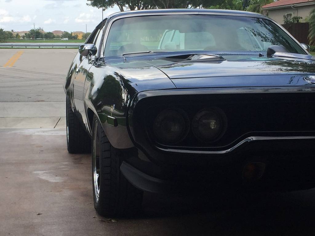

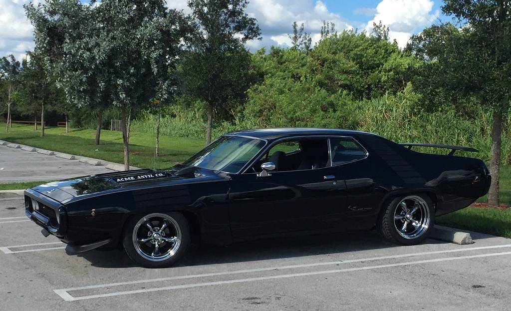

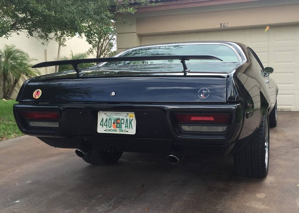

My '71 Road Runner had 16X8 with 4.125 back space & 255/50 tires on the front and 17X9.5 with 5.25 back space 295/45 on the rear, no rubbing or fender lip rolling.
!8 X 8 in the front 19X 10 out back, tires are 285's with plenty of room (I'll use 295's next time around). No modifications other than lowering it roughly 2".

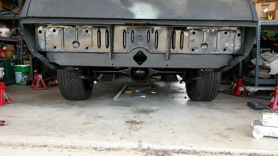

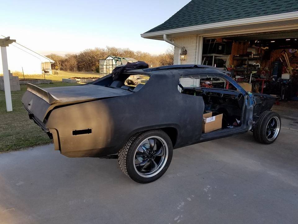

Thought I would update on the choice I made for wheels. These are 20s with 295s on the rear, 18s on the front. I came out needing a small spacer to clear the leaf springs but I'm happy with the outcome. I did get the measuring tool and still managed to get the back spacing wrong but not too bad.
Stance will be different with full weight of gas tank, drive train, etc. Coming along. Again, thanks for all the information.
View attachment 422609 View attachment 422610
What is your sidewall ratio for the tires?
That looks sharp!

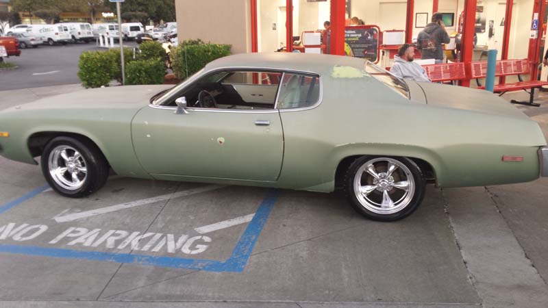

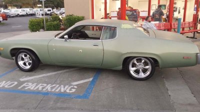

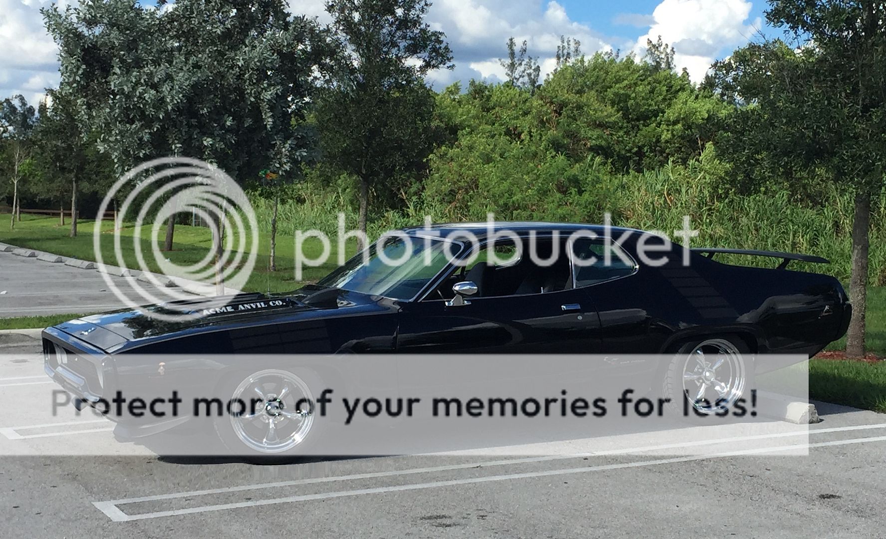

Here is my similar setup, and how it sits with 275 and 245 rubber, both spaced out about 1" w/hubcentric spacers:
One cheat I had to do was cut the front fender support that runs over the top of the tire. Partly the size of the tire and because it sits lower, it was hitting the top of the tire when hitting bumps. For now I cut it on the fender end and pushed it up out of the way, but one of these days I am going to have a shop weld in a 2-3" extension for it and reconnect it to the fender, but I really dont think that skinny little support bar provides much anyways.
