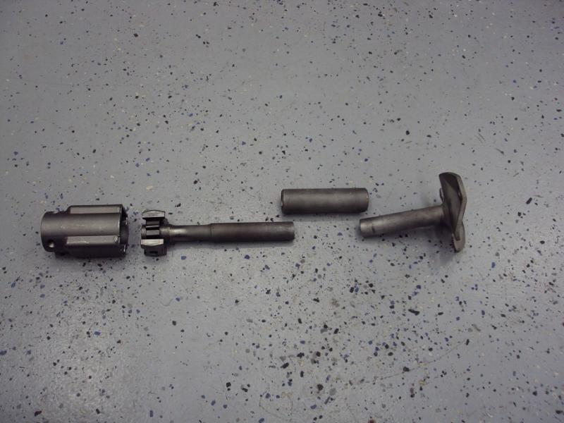

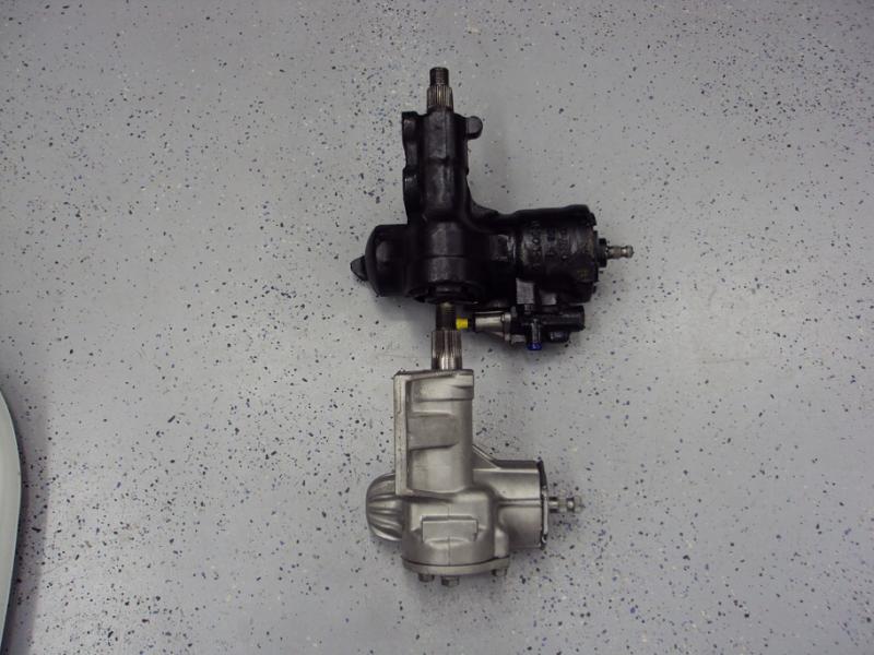

gearboxcompare.jpggearboxcompare.jpgsteering shaft length.jpgI went from power to manual on my late B. Set the two gear boxes side by side and measure them. The length difference is what you gotta cut off. In my case, I had to extend the shaft with a sleeve - welded to the column shaft - pic. Header clearance could be an issue also.
Also remember that the spline coupler is a different size. I believe that the manual is larger.(I may have that backwards)
