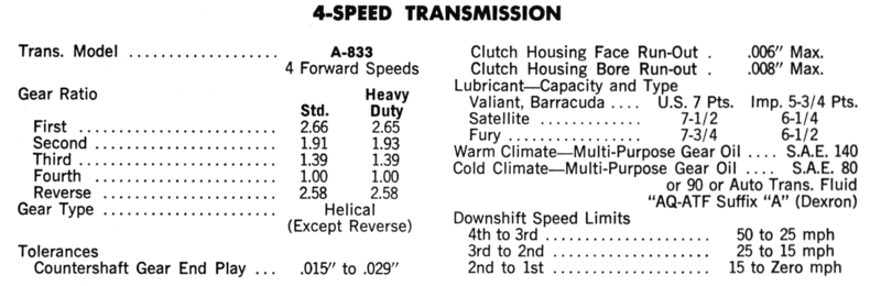

How much fluid does a 4 speed transmission hold? Need to order some.

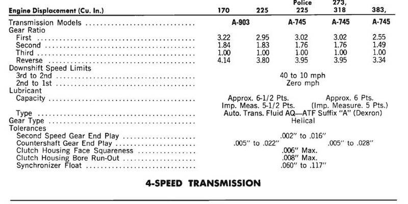

This post was wrong. For a 3 speed not a 4 speed!

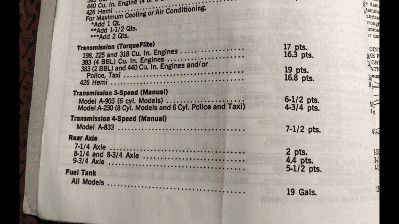

Wait a minute. That is for the 3 speed trans. This is for the A-833 4 speed. I just added the extra 1/2 pint and put a full gallon in it.
Just found this on page 4 of the manual laying beside me. I looked earlier and couldn’t find it
