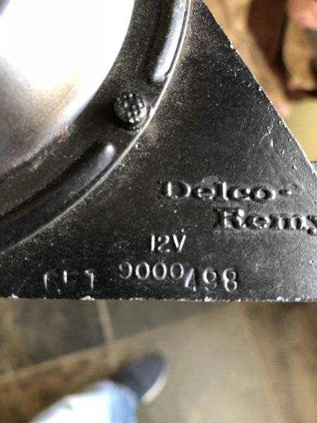

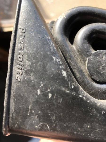

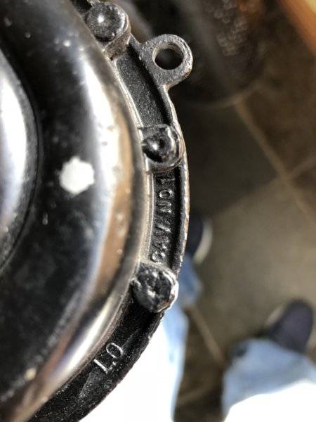

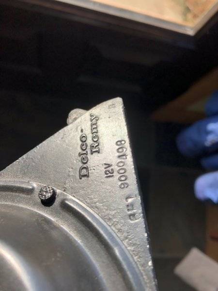

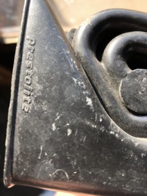

Here are a few pics
The top two pics is one horn and the bottom two pics is the other horn:
65D8A4D0-BDA2-4592-A83F-C77B66DB95AB.jpeg 4A6471F4-98A6-4FC8-9670-2BE4831D6235.jpeg 8DA2D816-9BDB-4CCD-B181-A29AD9D8CE8F.jpeg 9AFCB6CB-56F6-4A56-9D06-66399ACBE263.jpeg
The presto lite is correct for your year. The date stamp is on the bottom side in your last picture. There is one "high" and one "low" and both are stamped this. The delco is a replacement. I base that on the date of the 49th week of 68.....

The one prestolite is the “lo” dated
5 8
Probably the original from the car as my car is a March SPD.
Thanks!
5 8
I agree....and the high went bad and was replaced......Remember that's in weeks and not months. So 5th week of 68...given a 3 month window it is no doubt IMHO that is the original horn....
So keep in mind when you search for a replacement.....The pairs on my charger and the GTX have the same week......I have not researched them in great detail because I had the original horns...If they were missing I would have done more. So I cannot 100% say both horns have to be and exact match but two survivor cars I restored they did...
