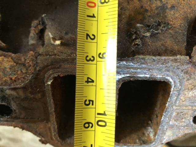

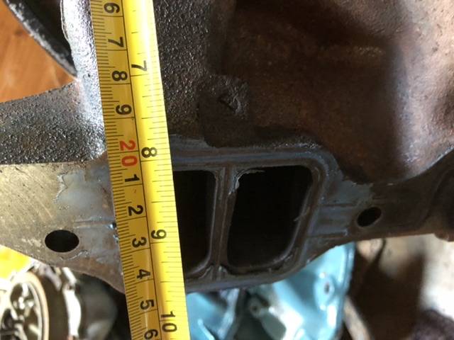

The bars at the end of the Valley Pan would be a good gauge.
One of each...
it's easiest to measure across , the b is narrower than the rb
also no 2 barrel rb.
sorry I don't have measurements in front of me. I can tell by looking at them but I've seen a few

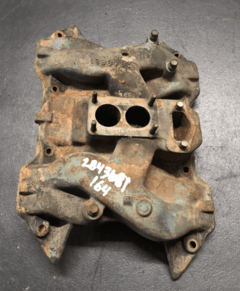

Oh, BTW there is a 2 BBL RB intake... It came from industrial engine applications... You just rarely see one...
2 bbl RB 383?
They also made factory RB 383 engines.....had one in a 60 Chrysler when i was a youngster....put a 440 4 bbl intake on it!
