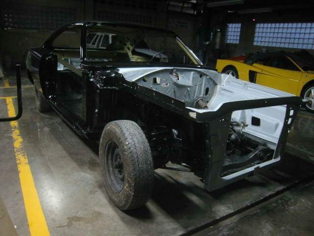

How to increase the strength of the 68 chassis

Anyway i would want to increase the strength of the chassis, but remain the original look not a roll bar racing look.

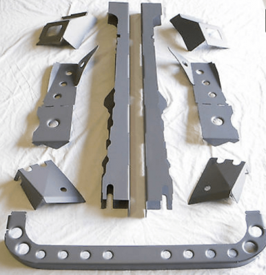

The 2 long pieces in the center of the pic are your sub frame connectors, those are the weld in style. You can get just the sub frame connectors alone in a bolt in style from Jegs or Mopar performance.
The weld in style will give more support but alot of guys use the bolt in ones with good results.
Thank you fou every reply. ..Another question please. Do any one know how heavy of the stiffenig kit. Just want to know not about the performance but about the Air freight cost. If it's too heavy it might custom made it in my country since the shipping cost will over the price of the stiffering kit lol
Thx for you reply anyway do you have idea how heavy it is .its about the air freight cost that might double the price of this kits.
If you are just wanting a set of frame connectors your prob right about getting some built local compared to shipping over seas. Go to Jegs.com web sight and search for bolt in frame connectors for your B body. That will give you a good view of what they look like.
If you email Jegs I am sure they will give you a shipping cost.
The full set you show in the picture I would guess the weight at aprox 15 to 17 lbs boxed but that is just a guess.
email uscartool with the part number for that set and ask them the shipping weight.
Thank for you reply. Another question plz if i bought the kits below do i still hav to buy the sub fram connector
The full set of chassis support you're looking at would do a much better job than simple sub frame connectors. It would probably worth the extra shipping you'd pay over and above just that of the sub frame connectors alone. I guess it depends what your needs are.
Where do the two in between the torque boxes go ?
