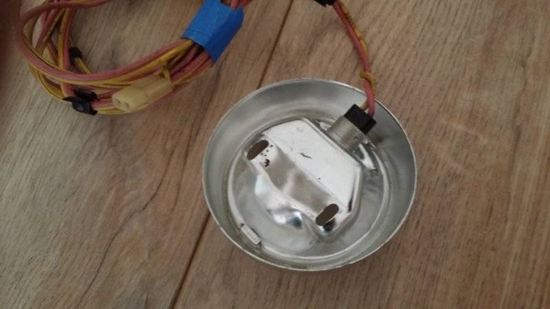

Hi there,
I recently bought a dome light for my 1972 Dodge Coronet. Problem is though, that there are no mounting points on the ceiling of my car! Does anyone know how this light is mounted, of if there is a clip or bracket needed to bolt it to? Enclosed to this message i posted a picture of the light i got. I think this is the correct one for the car (?)
regards. Willem

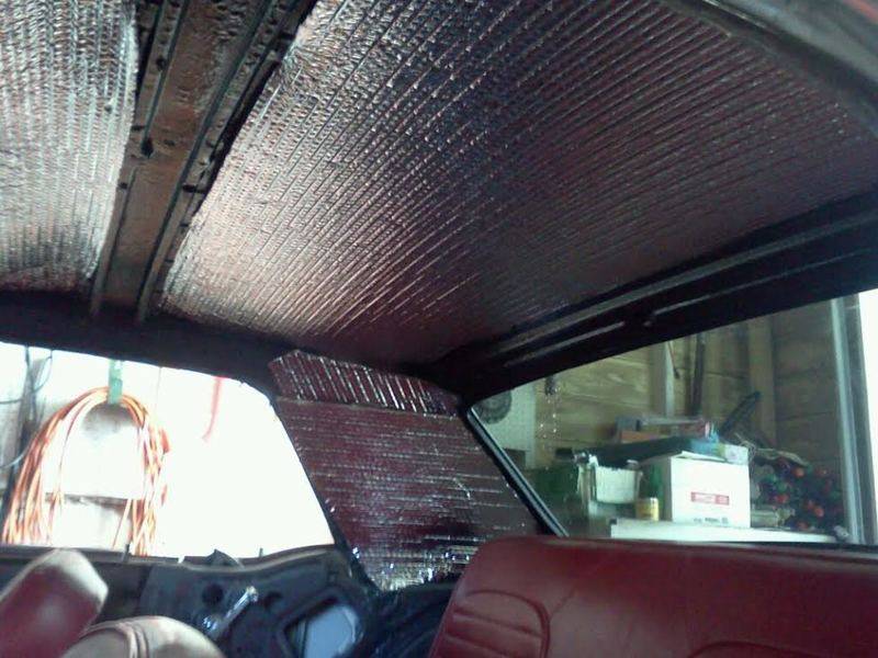

There is a steel reinforcement brace that runs left-right across the underside of the roof skin. The base mounts to the center of that brace. It may be hard to see/feel with the headliner in place.
Looks like this:
