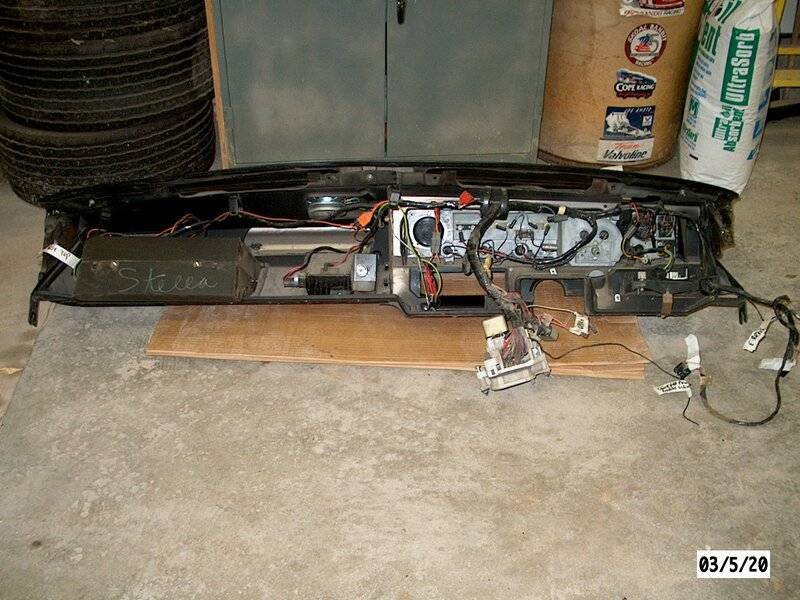

I removed the dash to get the dash pad off in my 71 Cuda.
The photos show the upper and lower bolt holes where the dash attaches to the car. Upper bolts are accessed through the vents and can be tricky if the glass is still in. Try 1/4" drive with long extensions, universal joints, and a short socket.
The dash pad is removed from the dash frame by removing the speed nuts as shown.
