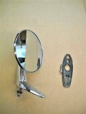

My mirror adjuster is rattling inside the door and I tried to remove the chrome side mirror from the outside. I loosened the one visible screw but the screw is still captured and something else is holding the mirror to the door. How do I get this thing off? It looked so simple haha!
There’s a threaded stud with a nut that you’ll have to access by removing the door panel. They can be awkward to reach but a good set of extensions make it do able.
You can see the nut on this mirror.

I'm just bustin' yer chops. :icon_fU: Logically if there's no fasteners in sight then they MUST be under it. Inside the door cavity would be the place to look. Some have one post and a placement tab and some have two posts. Roll up the window to get it out of your way and reach up in there. Remember to have a helper hold the mirror so it doesn't fall out and scratch up the door, or tape it up so it stays there till you can get a hand on it...
