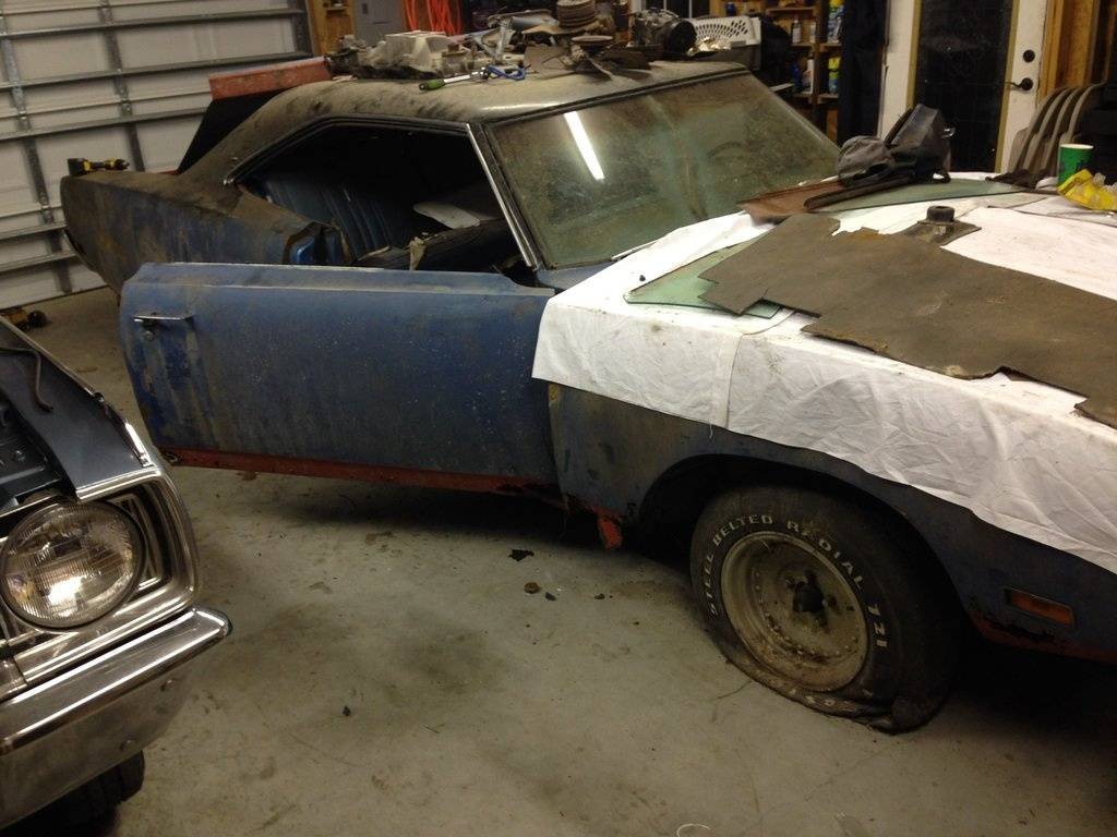

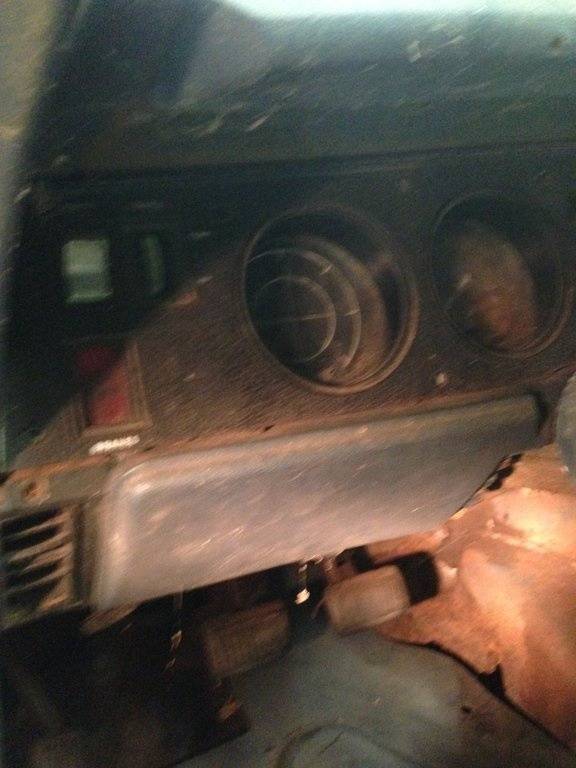

So to my point, I am trying to salvage pieces that somebody might want. I am pulling out the 150 mph dash cluster, and I need to remove the lower dash "pad"--I guess that is what it is called. The first pic shows what I am talking about. Can someone give some advice on how to get this out? I have most of the gauges disconnected, but this is keeping me from pulling it out.

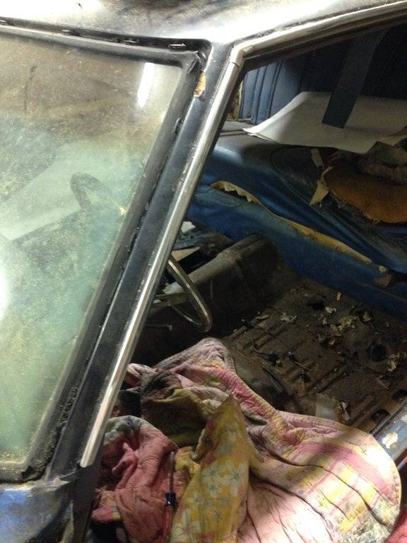

The other pics are some shots of the rest of the car. There is almost nothing left of the frame rails--as you might notice. I also want to remove the chrome trim above the side glass if anyone has some advice. I have never removed this trim, and it is not too obvious to me.

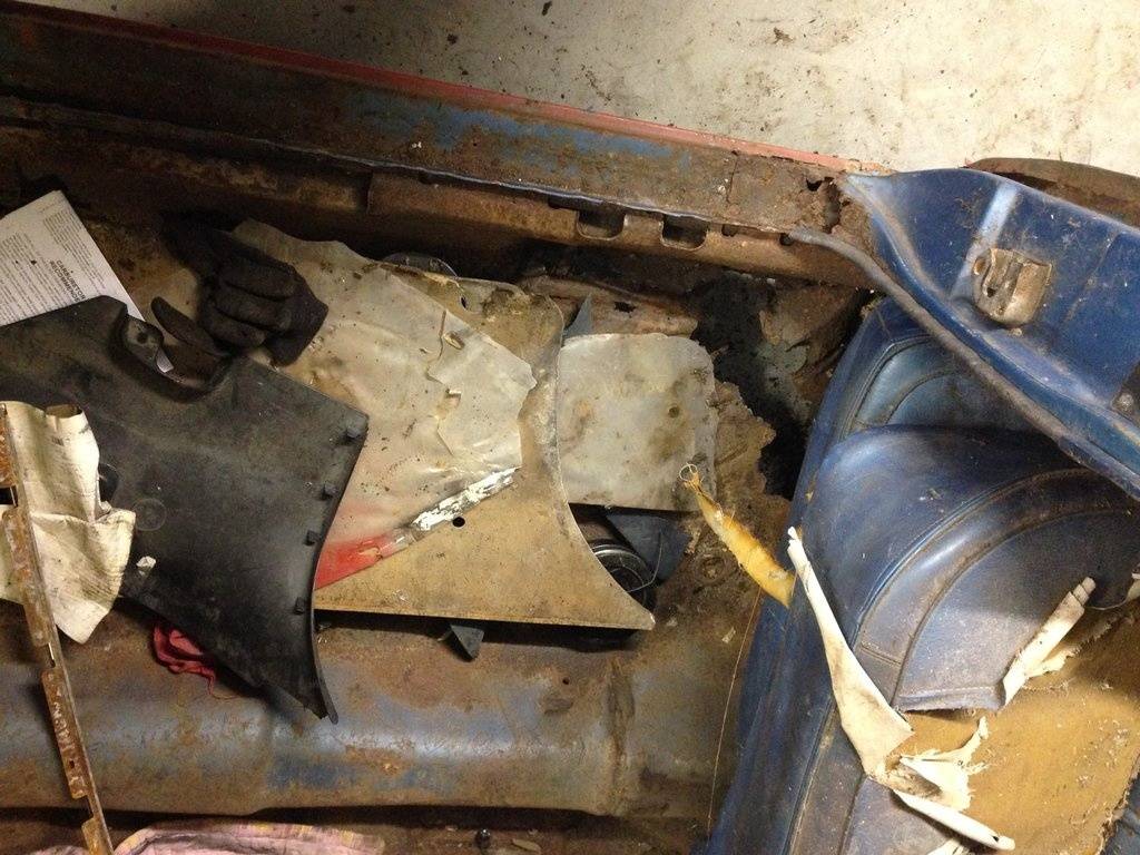

Sorry about the 3rd pic. I could not readily tell what it was, and I am the one that took the pic. LOL!!! Anyway, it is a sideways pic of the lower passenger doorframe. You can see the floor through the rusted out floorboard.

Those parts are held on by philips head screws that screw in from the back side of the dash. If you use a mirror and a light, you should be able to see them. I use a long philips screw driver and it works OK, but it is a bit of a pain in the butt.

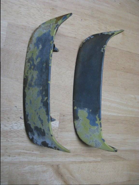

I need the trim on the side scoops. They are held on by two nuts on the back. Looks like this. PM me. Thanks.

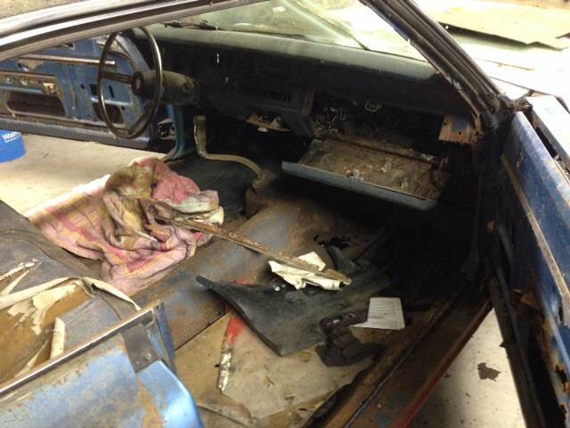

I pulled the radio, side air vents, middle air vent and map light. I took out the six screws that hold the heater and ac controls, but I am not even sure it is even worth it. The problem with these parts are if they survived this abuse, then they are probably in good condition in most other cars.

Man, those side scoops are in a bad spot. I have all of the interior piled in the back seat, and I wasn't planning on taking it out. However, I will make sure I get them when I take it to the recycler. I am going to guess those scoops have plastic female ends and that they are easy to break???

Those side scoops are pot metal like cast zinc, with two cast studs going through the quarter panel and two speed nuts on the inside. With the rear seat and inside panel out and window rolled up (I didn't check if you had a coupe or hard top) you can reach in and undo them. Because they aren't steel, they're usually not seized up.

Thanks Photon440. You beat me to the explanation. They don't just pry off or pull out. If you try that the studs will snap off.
