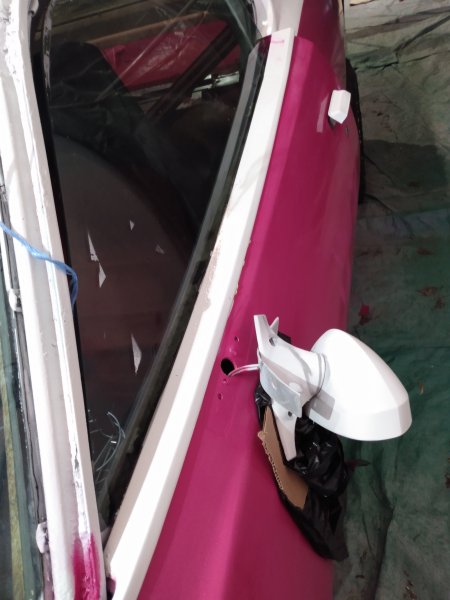

Wondering whats the best way to remove trim underneath the front and back windows on my 72 charger. I got the nuts on the ends but is there any screws holding it in or is it just held in by clips? Would like to remove for easier painting and vinyl top install.

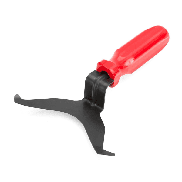

Window Moulding Clip Remover

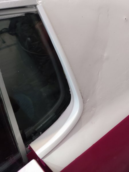

These pieces that are on the door panel and quarter panel I already have all the other trim pieces off the car
Agree with Hank, screws are under the window sweeps. Pull the rubber glass stops to lower the glass far enough to access.
