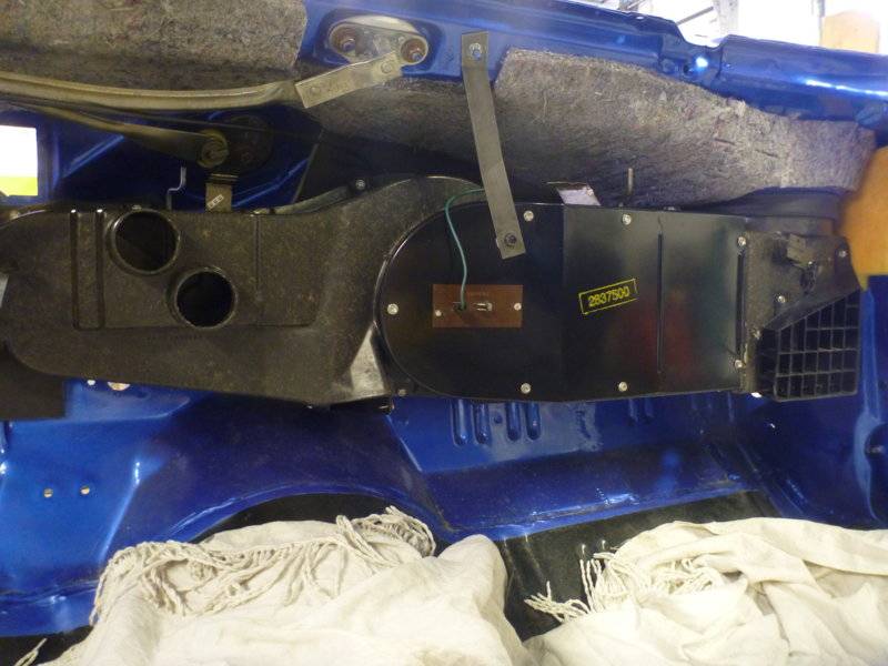

Take a small flat screwdriver and lift up the center "tab" and slide the retainer back in the direction of where said "tab" is attached to the retainer ring. The entire bushing/arm/retainer will lift off the linkage pin once you slide the "tab" past the pin.

Thank you, The manual says to remove the three attachment nuts and pull out the wiper motor as much as is possible, And remove the clip from the outside. This seems impossible. I'll see if I can reach it from under the dash.
Picture is my '69 Bee, 66/67 may be a bit different for location/stuff around it .. but I doubt it.
