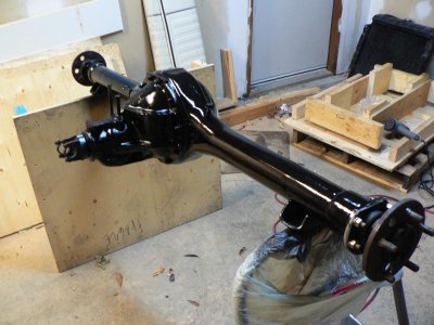

sanblasted primer and tremclad professional is pretty damn good

I have the epoxy primer on it now just waiting for it to vdry and then I'll finish it in semi black.
