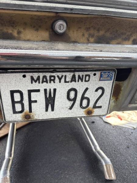

I’m technically the second owner of this car, it sat somewhere I guess for years. Some guy bought it and never registered it. Now I have to have the shop I bought it from title it and then sign it over to me.
