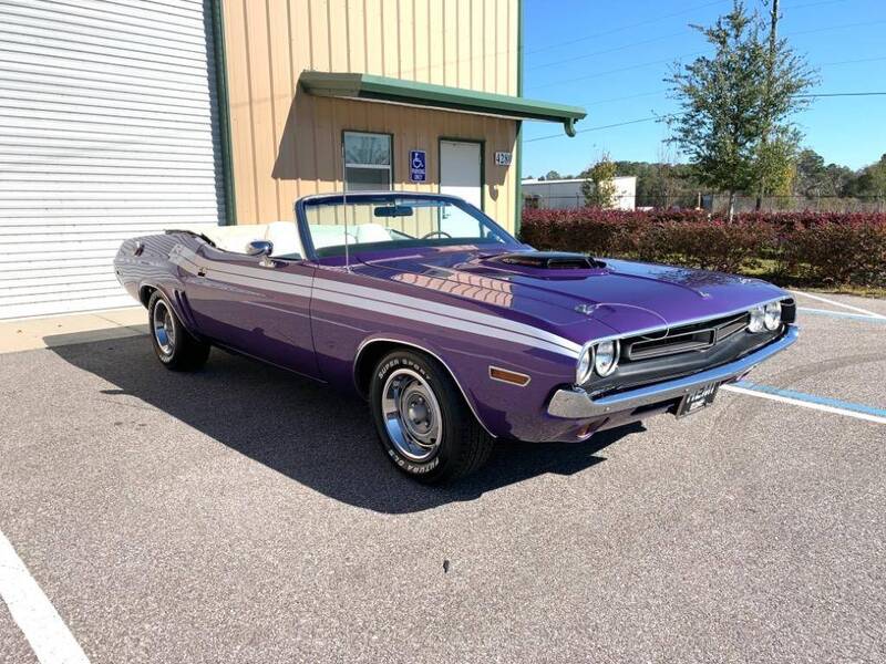

I found an interesting car for sale
Michael_
2:14 AM
Jan 31, 2019
1,632
1,791
Germany
https://orlando.craigslist.org/ctd/d/tavares-1971-dodge-challenger-rt/7365680007.html
Claimed dealer installed hemi in an original 383 car.
Interesting they did not swap out the 8 3/4" with a dana 60. Ad & paperwork do not giveaway if its a sure grip or not.
Also was there just one 4 speed or like the 727 a beefed up one for the hemi cars? Because it appears that they didn't do anything to the tranny either...
Paperwork states no unibody reforcements also (Especially interesting since this is a convertible).
Almost like swap out the motor and go. :D
But car looks nice and is interesting for sure.

They probably repainted it when restoring?
Because for me it looks pretty shiny/mirror like for a 70s paint job in these pictures ^^
This one looks more like a 70s factory paint job to me: https://www.hemmings.com/classifieds/dealer/dodge/challenger/2082433.html (Despite they say "Restored to original condition")
I personally like these old single stage acrylic enamel paint jobs over the high $$$ modern mirror like multi stage ones. :)
