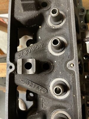

Found these stashed in a box with some other parts. A little help here please...I guess I never paid attention to it or just never give it any thought. What is the -1 & -2 that comes after the "915" casting? Also, is the 5 digit number below that the date of casting?

-1 & -2 are indicators of the casting mold.. -1 is a fresh mold, it might be truly fresh or nearing the need to be fixed... -2 has run long enough that it was repaired Same deal, it could be truly fresh or soon to be a -3...
And the second number as you surmised is a casting date...
67 closed chamber heads. the 1 & 2 are just casting mold adjustments. The heads marked K on the bottom are generally 1.60 exhaust valves and the L is 1.74. Not sure of this has been proven. I found most uncut heads to be 79-80ccs. No difference in castings. Factory HP heads have a large HP on the alternator boss holes. Over the counter heads have a small HP under the intake runner. casting dates are 216th day of 67 and 113th day of 67
Good information to know. With that info, does the -2 head have any inferior qualities over the -1 or vice-versa? As far as I know, these heads came off the same engine. And can you decipher the casting date, please?
As long as the valves and throats are the same they will flow the same. Make sure that they have the same cc chamber (no milling)

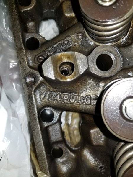

Can you tell me the casting date on this 915 head ?
Been trying to decipher this with no luck so far.

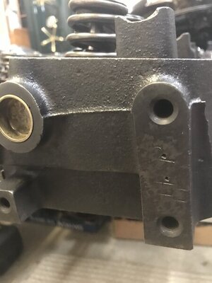

Also is this the HP stamp on the heads you are referencing ?
