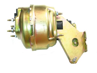

The pictures below shows the booster just move it out of the way.
