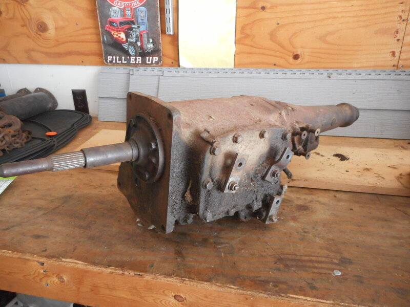

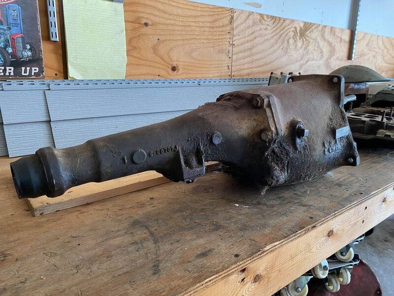

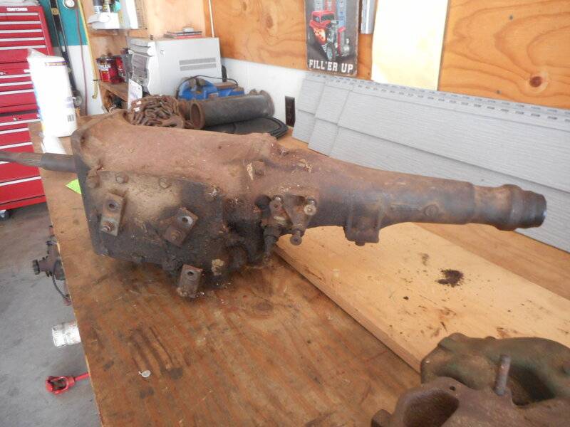

Can anyone help me ID this 4spd trans? Thank you.

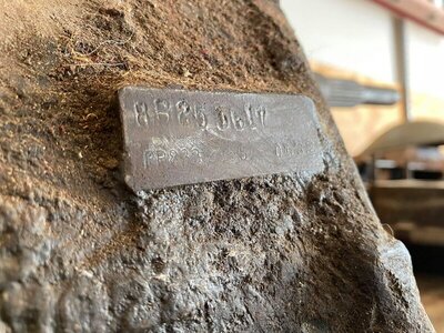

I see pp8332365 in the second picture. But really can't make out what most of the numbers are. Looks like it was cast 2/20/67 Guessing its a 67 833.

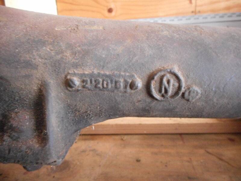

Serial number starts with 8B, so first installed in a 68 car. The tail housing was cast 2 20 67. I couldn't make out pp numbers. A picture of the input shaft would help, 23 or 18 spline. A measurement of the front bearing retainer is a help too.

From what I could see it says either.... pp8332365 or pp8332355. I think its the first number though. followed by 0032
First picture you can somewhat see the input shaft looks like a 23 spline.

Build date of this transmission
2355 = Monday, 8 Jan 68
2365 = Thursday, 18 Jan 68
0032 = # of this trans built on that date
looks like a "B" - Hamtramck built car
