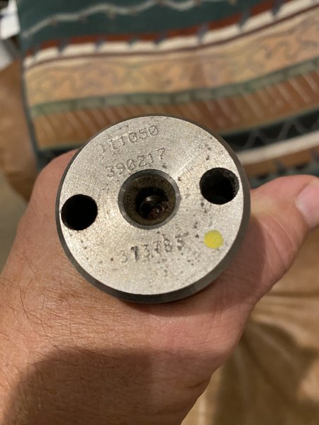

Is it possible to ID a Mopar purple cam from these numbers stamped on the rear?
I did some measurements with a vernier caliper. Measured the base circle then measured the max lift , subtracted lesser from the greater and multiplied by 1.5 rocker ratio. Came up with .463 intake and .450 exhaust, did they make a purple shaft with this approximate lift?
Somewhere there is a color code chart that tells the grind. I havent been able to find one though.
I have combed the internet for that chart, I also read that they were frequently marked incorrectly anyway. I think I have the stock 440 HP cam.
