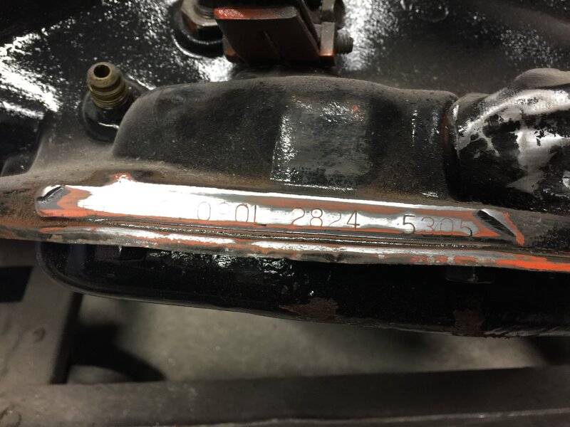

ID the trans ?
2824 date code is April 21, 1969
Is there also a VIN stamped on the case?
That is the id stamp on the trans ! Nothing else !
Ok so the stamping was dun by someone smoking herbs ?The numbers are clearly wisible but do not ad up whit the date !So produktion eror ?
Yes you are probebly spot on ! Thanks for the info !
From the pic it look it looks 2892090L which is a 727 from a '69 B or C-body with a 383-2. Same build date.

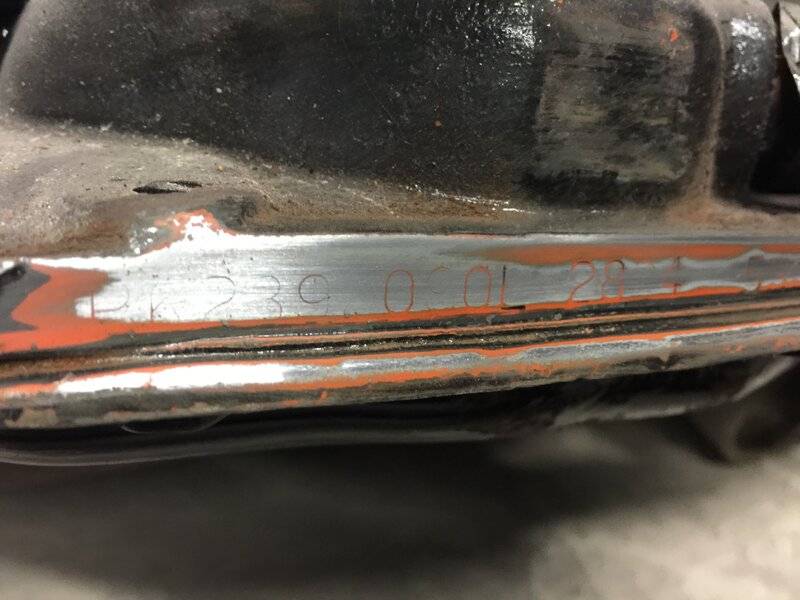

You should probably try and soak that paint off rather than file it off to read the numbers....lest the numbers vanish.

There are various date codes on the transmission castings if you look closely. Usually little sundial type of markings with a year in the middle. Might be hard to see unless the case is clean.
