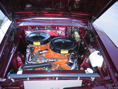

This is a 440 + .030 with Eddy heads, repro cross-ram from A&A Transmission, 600 cfm Eddy carbs, 10:1 compression--276 advertised duration cam with 112 LSA, 2000 rpm Holeshot T.C.; uses pump gas, runs perfectly (and I emphasize PERFECTLY) on the street. The engine puts out 535 flywheel h.p., doesn't overheat, and is completely reliable. With the sounds of your build, you're in for a real treat! Good luck and enjoy!

Ilm65..that already sounds perfect for me. Do you think that a strokercranck will give it more bump at low rpm or would a stock stroke be sufficient?

I used to use a standard 440 crank but now I have a 4.15 stroker crank. Ron

Nice combo and it looks good !
Talking about not overheating as last night I went to a local show and got stuck in traffic for 45 minuts. Moved about a car lenth every few minutes. After my temp hit 190 I turned on my added electric fan thats in front of the rad. Sitting idlig for 45 minutes it never went over 192 and it was in the 80's here yesterday. No problem with the 92 pump fuel boiling and never overheated. That was a good test for my cooling sytem. Ron

I caution you about becoming too firm with a decision to use a stroker crank. My "maxie" uses the stock 440 forged crank: Plenty, plenty torque--will easily "pin" you against the seat--and break the tires loose to the point of no control from 30 mph. Max wedges can easily make upwards of 500 hp; what more do you want for the street?
