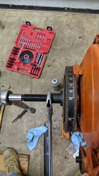

I'm on it with a pipe on the end of my crescent while holding the crank still using an actual installer and I can't get it to budge anymore.
You've got a burr on the key or keyway or something. Was it an original couple, or is this a new crank or dampner??
As Wild said, pull'm apart before you jam them any harder and figure out the issue. Bore to small, keyway too tight.. should pull right on with little effort.
Took it back apart and checked for a Barb, I don't see anything that's catching, no mark of where the interference is. It goes in like butter then a hard stop. The bore looks just like another I have here, I guess I'll try that one. The original's rubber was bad
Didn't have any of that apart, only took the balancer off to replace it
Sounds like it needs honing, period......
That's how they make (most of) them, they have a little more clearance in the back to help get them going, but they need to be honed very slightly to get all the way home.
Most shops around here charge very little to do it. (My guy will do it for a Pepsi:))
Don’t happen to have the bolt from a small block by mistake? It’s a little longer and will bottom out right about there.
If I leave it like that my pulleys won't line up.
Unfortunately it's getting harder to find people who do little stuff like that around here, people are retiring.
I can understand that. Well...another option, if the fit is the problem, is to hit it with a power drill and some fine grit a-la Roadkill Garage.....quickly and smoothly. One or two passes in and out should do it. Not the best way, but when that's all ya got....
That's basically the idea, the ol' "hone it at home" trick
Hey, are you actually certain it's not all the way on, and it just doesn't align the pulleys the same? Some aftermarket dampers do that too and it takes spacers and stuff or, some people even mill the balancer (I'd be getting something else if it came to that)....just a thought.
Measure the depth of from the back of the damper hub to the bolt surface & compare it to the original...
Not seating the damper fully has bigger problems than pulley alignment, the crank timing gear is now only indexed by the key... The key isn't designed to take the load of driving the camshaft, the clamping of the gear between the damper hub & the shoulder of the crankshaft is what drives the crank gear....
I wish I had the original here, it's at my house 4 hrs away. I'm sure back in Chicago I can take the old one and this one to someone and get the right size... That just doesn't align with my hopes of making progress while I was here.
I compared it to another 383 I have here and it needs to go at least 3/8" more
