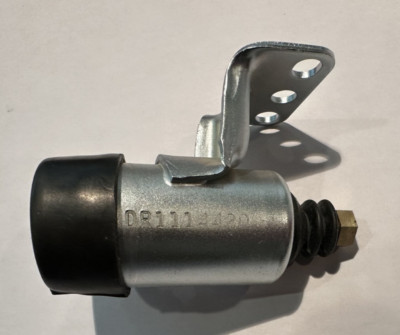

hey anyone- i dont want to pay $500 for an idle solonoid- Ive heard theirs an alternative one that looks similar and is much cheaper ??? anyone know thanks!!
There was a very poor reproduction available for quite some time. However, I do not see it via a quick search.
I have some nors but they are packed for Carlisle I will see what I have left afterward. Think they were 125 each DR1114429

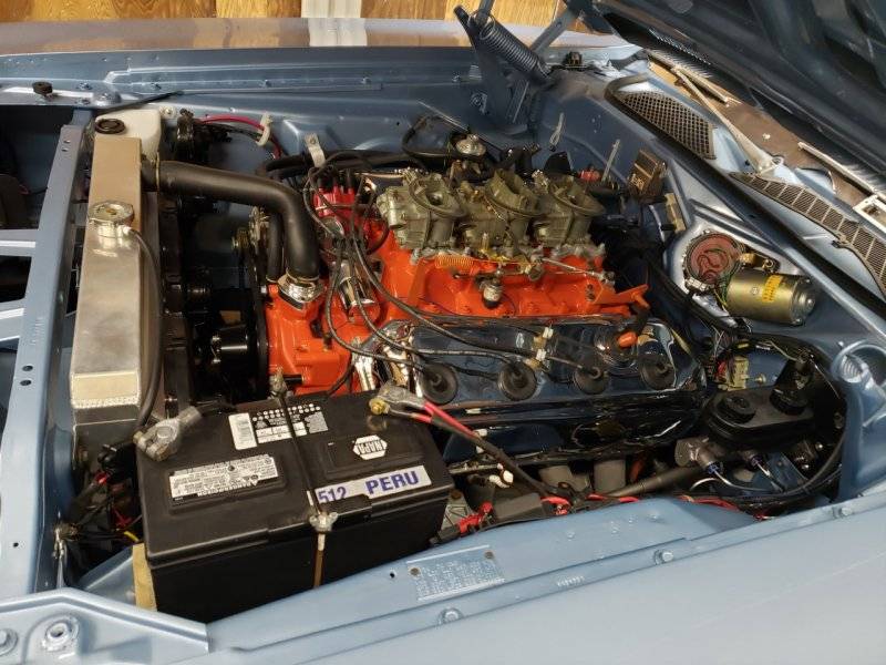

IMO.....my '70 GTX RS23V0A****** has the hot idle solenoid and it works perfectly as intended. The HOT idle speed is about ~ 1200 RPM because of the cam. The off idle speed (solenoid de energized) is about 700 RPM and had a poor idle because of the cam. The solenoid assembly was built by GM/AC-DELCO for Chrysler. Is it necessary ?? For an authentic looking/presenting vehicle.....yes. Some people say no...yet most agonize over the price but spend an as much or moreu on paint or wheels/tires or a sound system or what oil to use or wax to apply......you pay your $$$ and take your choice.....I prefer authenticity.......
