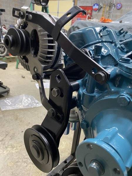

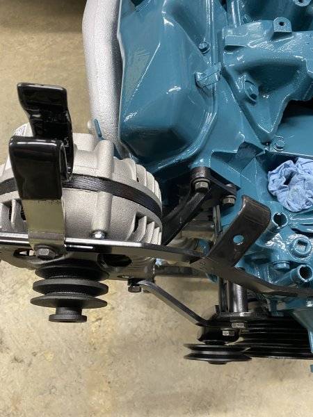

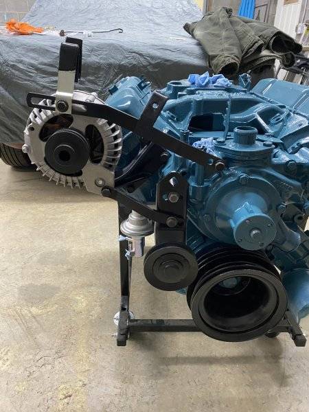

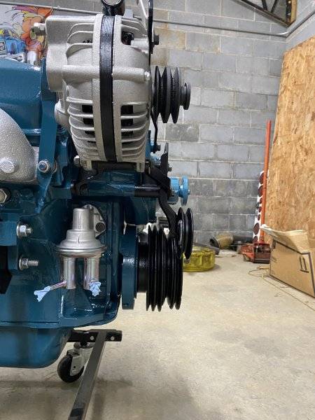

Not sure whether this needs to go in the engine section or electrical. A mod can feel free to move it if need be…….So trying to figure out the alternator brackets and idler assembly mounting proved to be a little bit of a challenge. None of it was on the engine so I had no idea how it went. I could find a lot of 69 up pictures out there, but not many that related to a 68 and there weren’t any good pictures in the service manual either. It took a little time but I got it sorted out and figured I would post some pictures to help others out with it. Looks to me like the crank pulley will have to be shimmed out a touch maybe
So trying to figure out the alternator brackets and idler assembly mounting proved to be a little bit of a challenge. None of it was on the engine so I had no idea how it went. I could find a lot of 69 up pictures out there not many that related to a 68 and there weren’t any hood pictures in the service manual either. It Tom a little time but I got it sorted out and figured I would post some pictures to help others out with it. View attachment 1804193View attachment 1804194View attachment 1804195

Let's help you, I see problems. The small adjuster pulley is in the wrong place front to back.
Belt order is:
rear 2 go to Alt and A/C compressor
3rd is the adjuster and water pump belt.
4th or Front belt is PS pump only.
So see if the rear 2 are lined up with the alt and AC compressor.

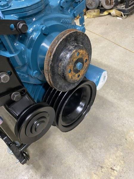

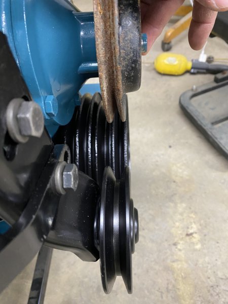

I appreciate it , but I think you are off on that. The spacer behind the idler sets where it goes. Also this is the original water pump pulley and crank pulley. They line up on the front groove along with the idler pulley. The power steering pump would be second from rear, but this car didn’t have power steering. Here are pics. I haven’t gotten the WP pulley cleaned and painted yet. And yes the rear two grooves are lined up with the alternator
I believe you should be using a 2 groove water pump pulley and it will be smaller diameter than the single groove.
383 A/C cars with/without power steering used the same 4 groove crank pulley.
Part # 2465326 Used in all B and C body B-block ac equipped cars.
440 engines used a different pulley.
The outside groove is for the water pump.
The next groove is for the power steering.The two inside grooves is for the alternator & A/C compressor
I appreciate it , but I think you are off on that. The spacer behind the idler sets where it goes. Also this is the original water pump pulley and crank pulley. They line up on the front groove along with the idler pulley. The power steering pump would be second from rear, but this car didn’t have power steering. Here are pics. I haven’t gotten the WP pulley cleaned and painted yet. And yes the rear two grooves are lined up with the alternator View attachment 1804347View attachment 1804348
That matches the setup on my 67 383 with a/c. 4-groove crank pulley. Front to rear belts are: single water pump & idler belt, single ps belt, and double belts on a/c & alt.
Yes. Sorry. You've got it right.
I'll tell the Doc to adjust the meds again! LOL
Yes that water pump pulley is correct.

Not sure whether this needs to go in the engine section or electrical. A mod can feel free to move it if need be…….So trying to figure out the alternator brackets and idler assembly mounting proved to be a little bit of a challenge. None of it was on the engine so I had no idea how it went. I could find a lot of 69 up pictures out there, but not many that related to a 68 and there weren’t any good pictures in the service manual either. It took a little time but I got it sorted out and figured I would post some pictures to help others out with it. Looks to me like the crank pulley will have to be shimmed out a touch maybe View attachment 1804193View attachment 1804194View attachment 1804195

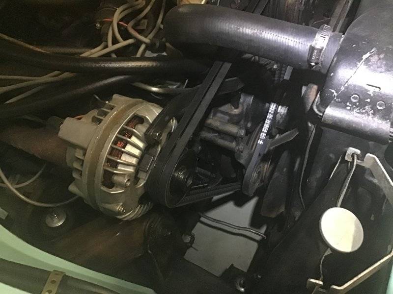

I have never seen that setup before. Here's mine.
Looks like my 67. Never seen those long heater hose nipples before. Might be correct - not. sure.
On a side note everyone tells me I am going to wish I had power steering on this car. I am trying to go back 100% as it came. I figure I will see how it drives when finished. I have a small block car that is a four speed and no power anything and it isn’t bad at all. Drives really nice in fact. I think it’s all in how you try to drive it. I am a farmer so a whole lot of our old equipment didn’t have power steering so you have to be moving a tad to get it to turn easily. Maybe that’s why I don’t see as it as that big a deal. I do have a power steering box and pump on the shelf if I decided to add it later on.
This is very helpful. I am in the midst of trying to mock up my accessories and add Classic AC. My 68 was an AC car but the prior owner removed the AC. Your pictures let me know that I seem to have the right cast alt. bracket, and lower leg; the correct crank pulley, and likely the correct water pump pulley. The exploded diagrams in the manual get a little cluttered, but your photo's are very clear.
