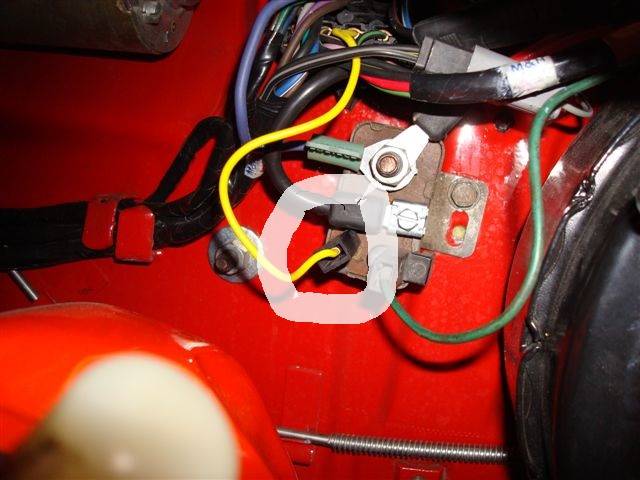

Hey everyone,
Im having a problem with the ignition wire being loose and once the car is driven, I have to pop the hood and push the wire back in for a solid connection in order for the car to start. Any tips on how to keep a tight connection on this wire without replacing?
See photo attached.
It's not technically an ignition wire.
It energizes the coil on the starter relay.
You can slide a jewelers screwdriver inside the housing and there is a flat tab that keeps the housing in place.
If you can get the housing released and slide it off then gently squeeze the connector where it rolls over to make it fit tighter.
Test the fit and then clip the housing back over the connector.
