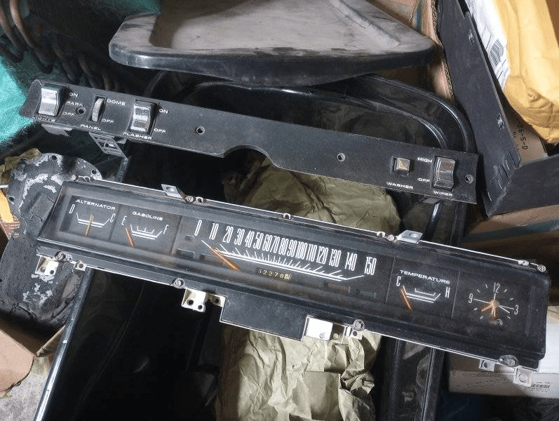

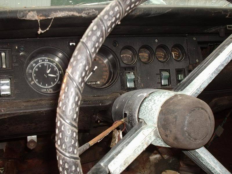

Some pictures show a rallye dash with round instruments and some show a sweeping speedometer dash. My '70 Coronet 500 has the sweeping dash. If the R/T dash is also sweeping is there a different top speed shown?
A rallye dash is a rallye dash. Sweep is sweep. With 2 different speedo flavors.
Rallye (Cool round gauges) optional on the 70 R/T although it was standard on the Super Bee. So the R/T could have had either from the factory. I don't know why for this weirdness but that's the way it was.
So the 500 had a 120 sweep and the R/T had a 150 sweep or a round 150? And, was the rallye exactly the same unit used in the Charger?
