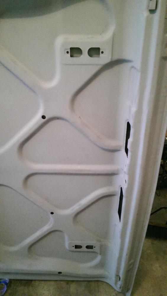

im looking for a template to install a wing or a spoiler on my 72 charger

HI everyone I'm new to this site...if someone can help me or point me in the right direction I would appreciate. Thanks Wayne
Welcome to the site I'll send you a p.m. I can help you out I have a factory winged trunk lid in the shed
Look underneath the trunk lid. It should have the mounting holes underneath and just drill up from the bottom. Get a 2nd opinion because I've never installed one, but I was pretty sure all trunks had the cutouts/holes underneath.

thanks for the info..but I'm doing the rear spoiler on the trunk lid..thanks Wayne
thanks... but no cut outs

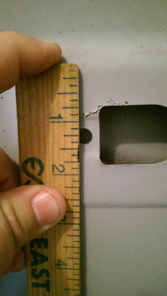

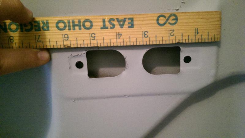

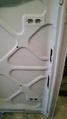

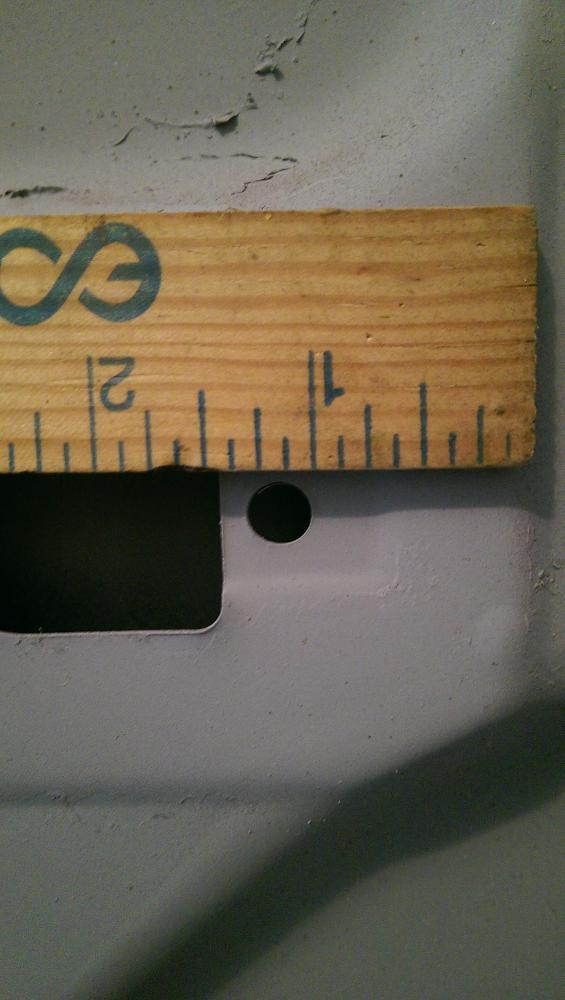

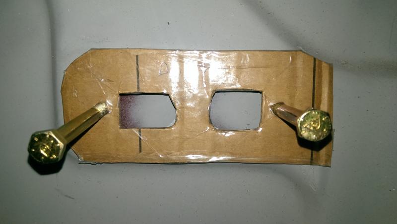

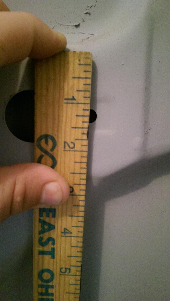

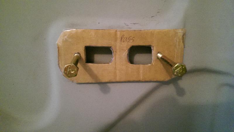

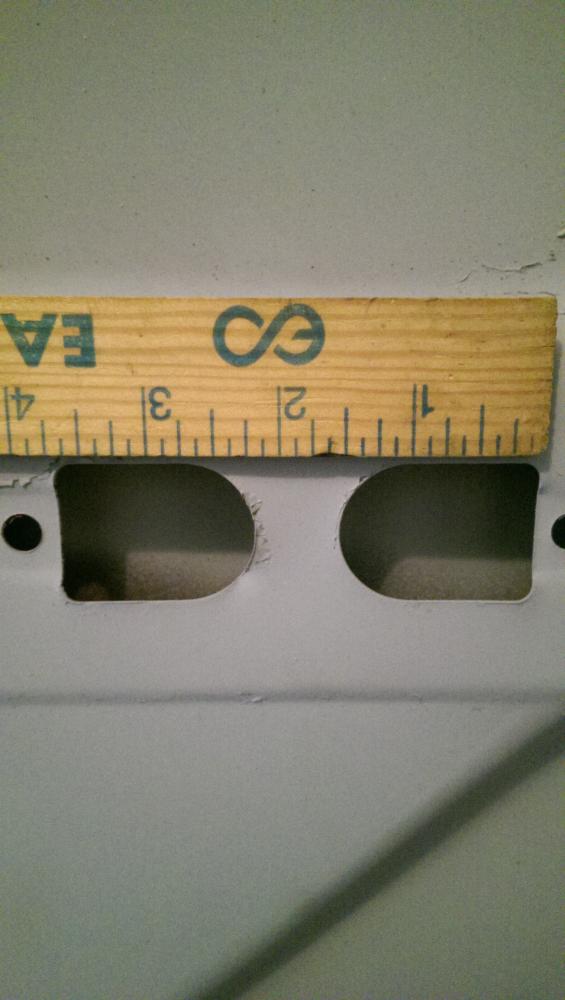

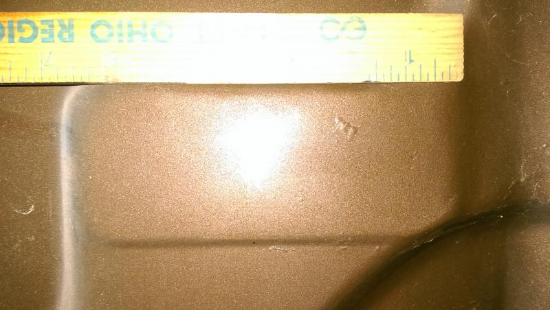

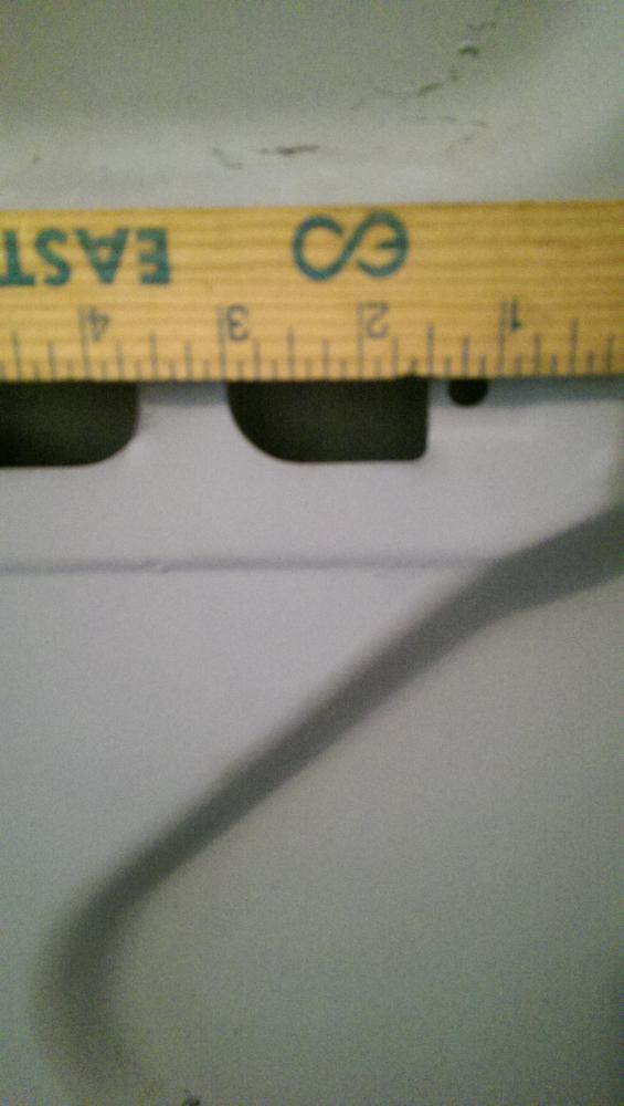

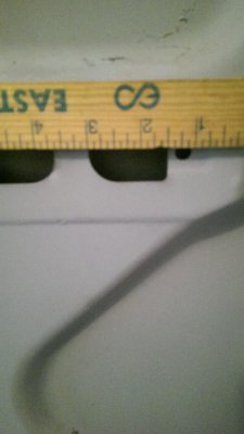

I sent you the email but wanted to put the pictures up on here if anyone else needed the measurements
IMAG0872_BURST002.jpgIMAG0873_BURST002.jpgIMAG0874_BURST002.jpgIMAG0876_BURST002.jpgIMAG0877_BURST002.jpg
The last two are the template I made up for you , I'll get it in the mail
By the way not all trunk lids have the holes only the factory go wing cars , I've had quite a few of them with and without .one of the above pictures is of my gold trunk lid with out holes
