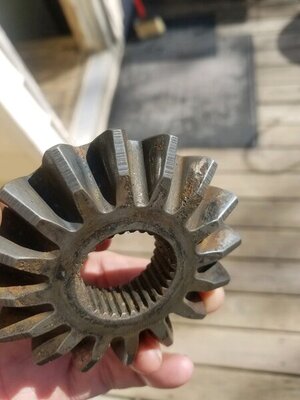

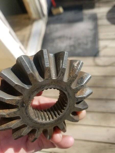

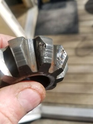

Im rebuilding a sure grip cone style rear end. A few of the spider gears are pitted. I cant find these parts anywhere. Here are a few pics of what I got. Thanks

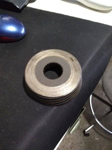

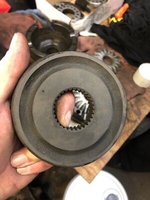

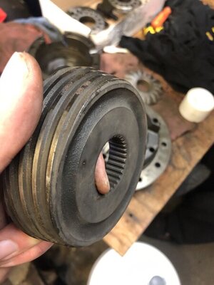

When you go back together, put a couple of small bits of clay on the faces and evenly tap them down into the case halves and see how much clearance there is. If there's around .030" or so clearance, you're good. If the clay is paper thin or so....machine some off of them.
