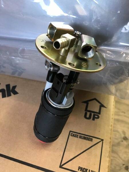

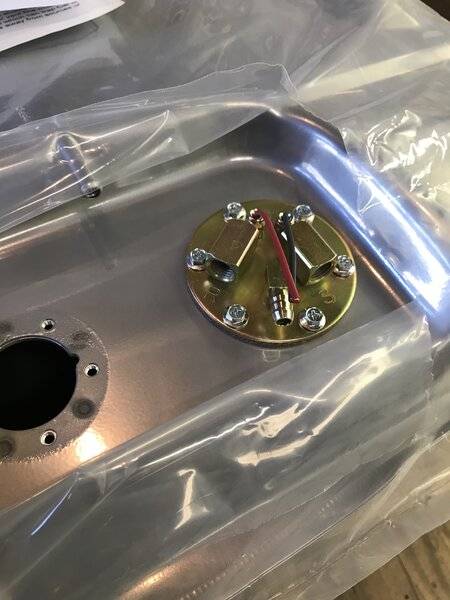

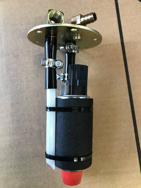

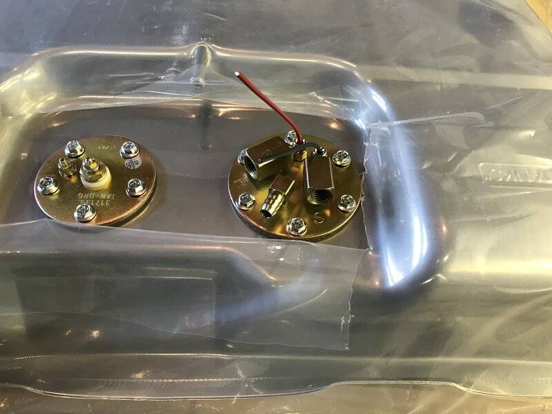

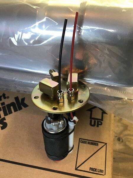

Tanks Inc makes fuel pump setups that can go in a tank that is only 6" deep. I just purchased a complete setup from them for my '68 coronet. They send the individual pieces and you have to assembly it. The EFI tank they make for the '68-70 B-bodies is only 6 5/8" deep where the pump sits. The link below will take you to the TanksInc page for the GPA-4 fuel pump that was supplied with the tank I just purchased. It is rated for the 255lph. They also have higher flow versions available if needed. They use Walbro fuel pumps, which was the deciding factor for me to go with the TankInc tank.
https://www.tanksinc.com/index.cfm/...ct_id=227/category_id=61/mode=prod/prd227.htm

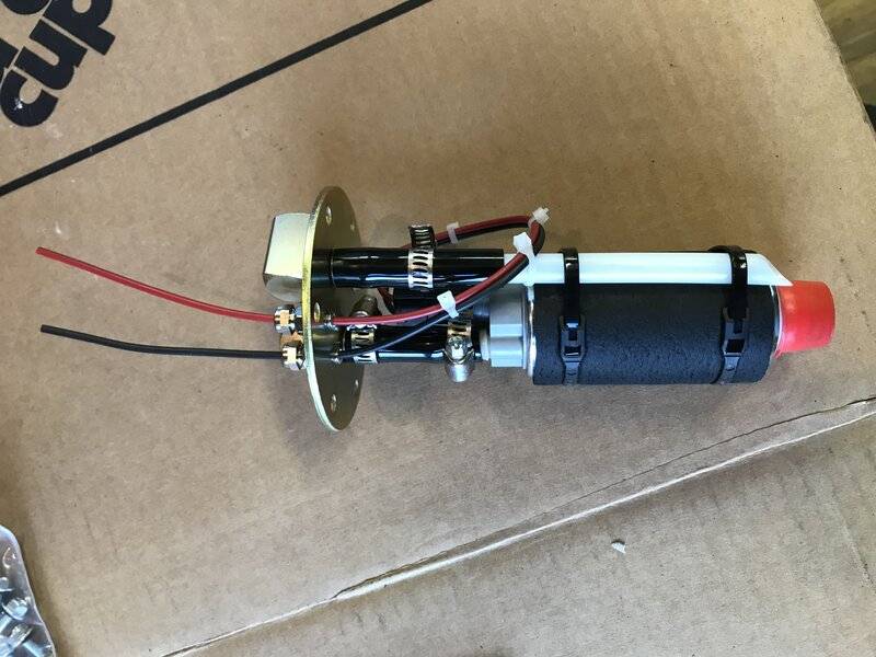

Here are a few pictures the fuel pump assembly after I finished putting it together. You have to trim the supply and return lines and then attach the pump and wiring. The supply and return connections are 1/4" NPT.
