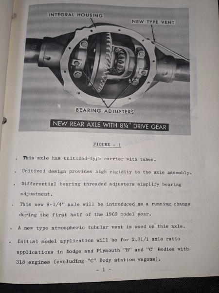

The Chrysler 8-1/4" rear axle was introduced during the 1969 model production run B-bodies and C-bodies with 318 engines. The only available original axle ratio for the 1969 8-1/4" axle was 2.71:1. The 8-1/4" rear axle is a Salisbury type assembly and differs from the banjo type 8-1/4" rear axle used in 1957 to 1962.
Due to the late introduction in the 1969 production run, the 8-1/4" rear axle is not included in the 1969 service manuals. Some information is in the 1969 Service Highlights and the 1970 service manual is suitable for service operations on the axle.
The axle continued in production and expanded in use over the model lines. Additional gear ratios and Sure-Grip was later added to the axle offerings. It was available after 1969 in the following applications depending on other equipment and duty ratings:

From 1969 Service Highlights:
FYI...
