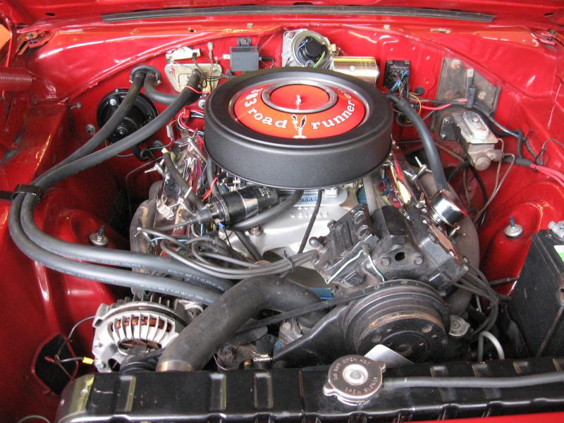

inside of the engine compartment should be painted body color,the splash sheilds on my car are black mopar pics 012.jpg
