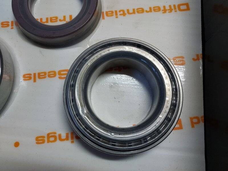

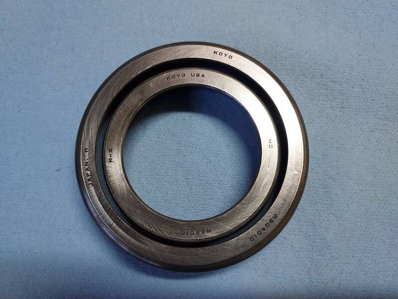

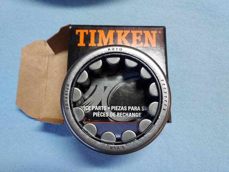

Don't be surprised if your Timken box has a Koyo bearing in it. Something about Koyo buying out Timken? Been this way for awhile but I've always received Timkens in a Timken box until recently. Does say USA on it.
Then the ones I just removed had KOYO USA and JAPAN on them.
The differential rebuild kit I bought does have all Timkens/USA.
It's the world we live in anymore.
